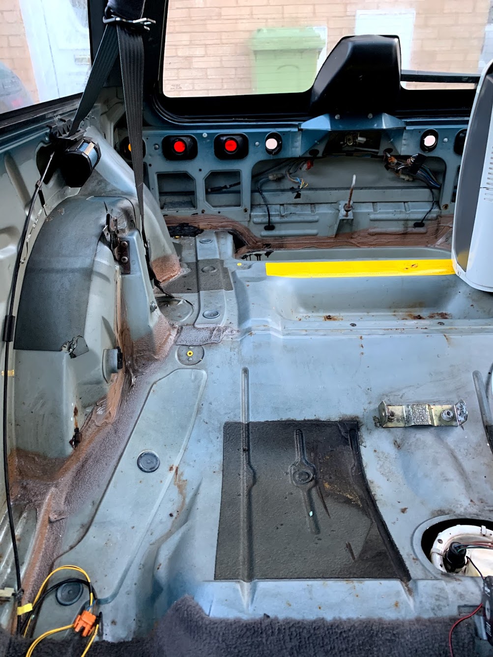

First up, the boot carpet was removed, along with the rear plastics.
This revealed a few things:
A surprising solid rear floor
and a rather large spider living in the rear wheel cover.
Screamed and threw it into next doors garden. Contemplated burning it to play it safe, as I've plenty of spare ones......

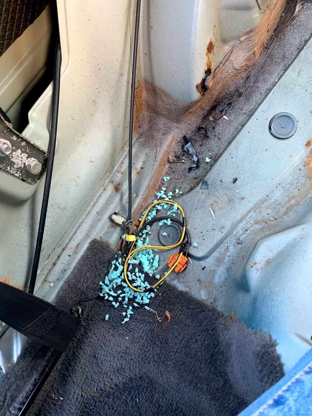

Finally, see the picture with the blue stuff on the carpet? Well, imagine sticking your head (or camera phone) into the arch (where you can see the sound deadening and the release cable) and looking back towards the wheel arch....
That's what you see....
and what you don't see, is any rust!

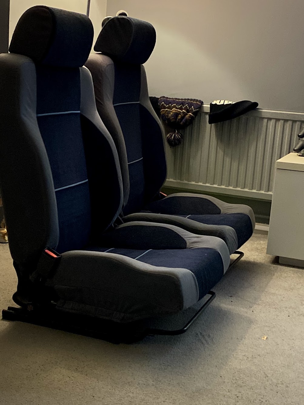

And thus my living room gained a new pair of seats

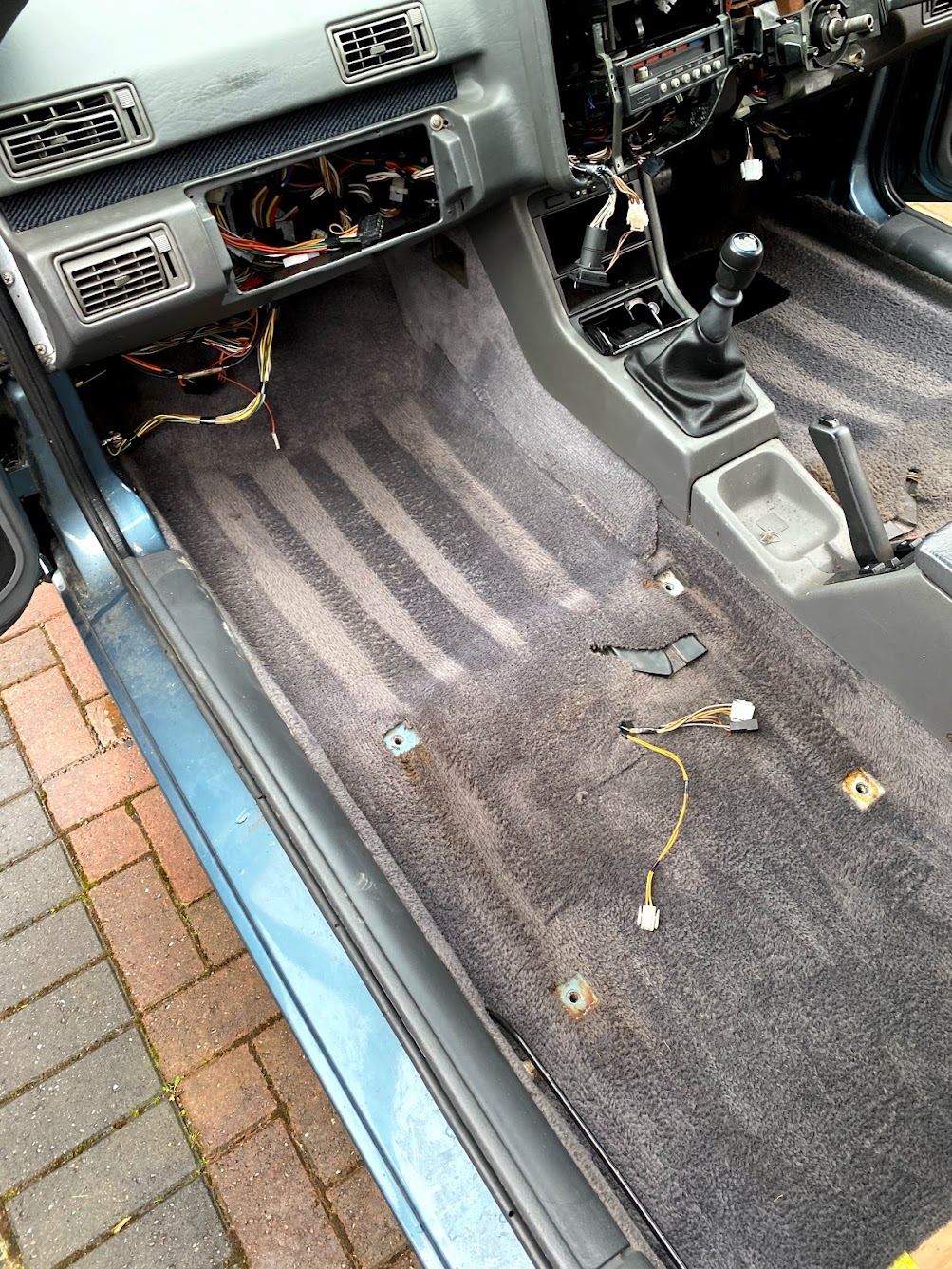

Of course, removing the front seats left us with some more challenges....
But this is not our first rodeo.....

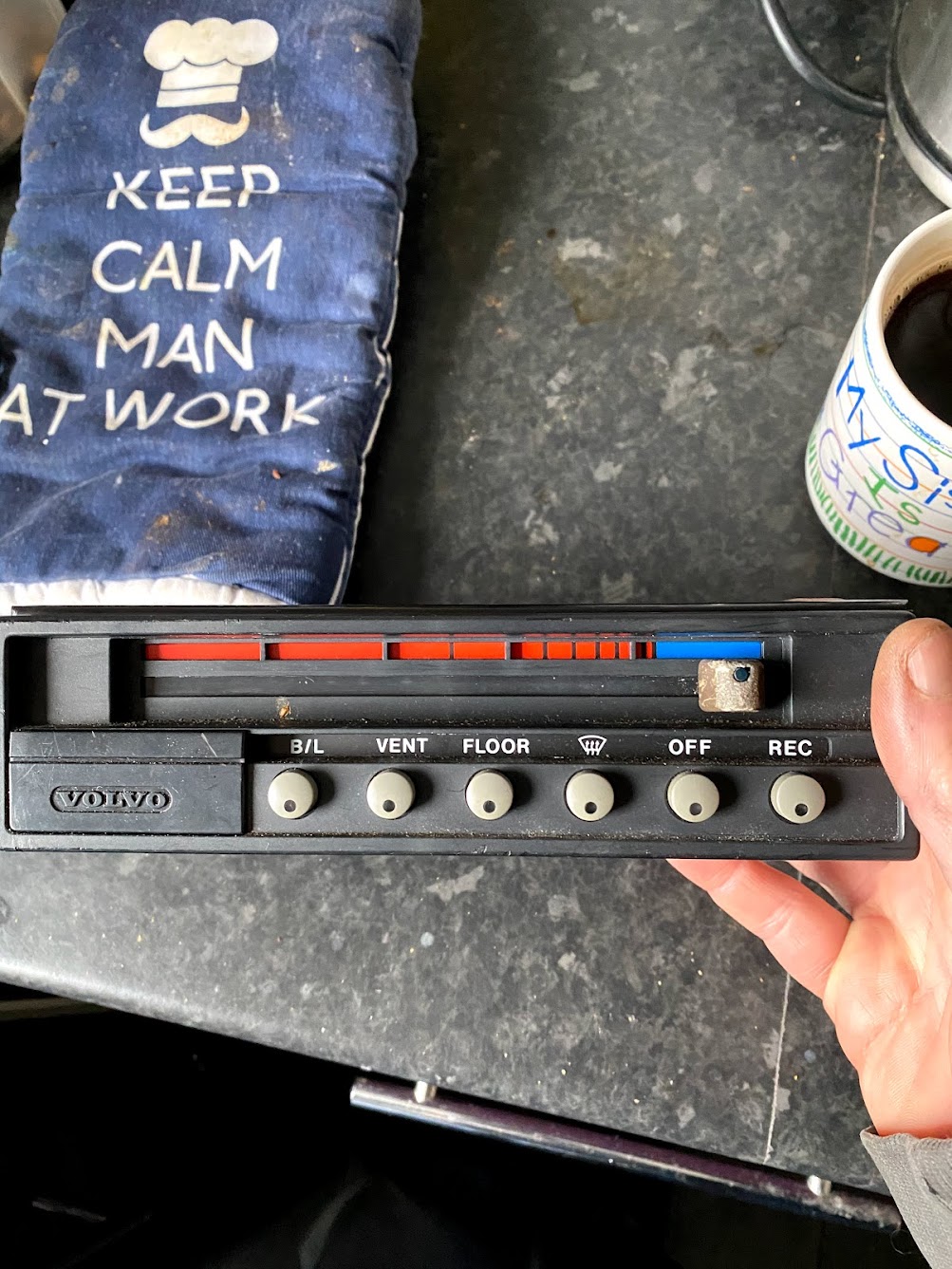

Drying the carpets would be great if the heater worked.... which it didn't.
A quick bit of troubleshooting led me here, tucked up in the corner near the CEM, viewed through the removed glovebox.
after re-making the three earths, we had a working fan, but no means of changing direction, which means....

That vent control panel is different to mine, either this is one of the last of that style or mine is one of the first of the simplified style (no buttons)

Car seats in the house and fed up with the cold working conditions.... snap!
Just skimming the old photos and its good to see other cars with trim panels removed. In particular, the wiring harnesses secured with whatever tape the factory could find, and the mounting method of the red "bulb-monitoring" box at the nearside rear quarter. I looked at mine and laughed saying no way that's factory... .errrr yep it is!
One day, maybe one day, i'll have a 480 with stripy carpets. We can but dream
