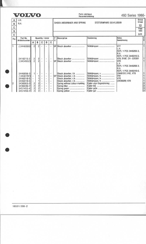

Re: WANTED: Rear Springs
On the front, springs were either black (unmarked), blue, green or yellow.
Fronts (colours the parts catalogue; rates from this forum):
Black 17Nm Spring Stiffness; 372mm length
Blue 20Nm 360 length
Green 17nM 362 length
Yellow 20Nm 350 length
Fronts also menturned elsewhere on the forum that are probably 440/460 or lowering springs.
Grey 12Nm 457 length
Red 22Nm 355 length
Red 22Nm 355 length
