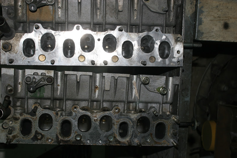

I have bought a used B18FT engine (160 000km) but when i disassemble it i found that the head is dead, crackeb between spark plug and intake valve :
I have a 1.7i head in stock, so take it and begin to port:
Many to drill :
After some hours :
The head is 90% finished, but don't have pictures.

Post by leon_pp » Wed Sep 07, 2011 10:59 am
before/after :
from near:
