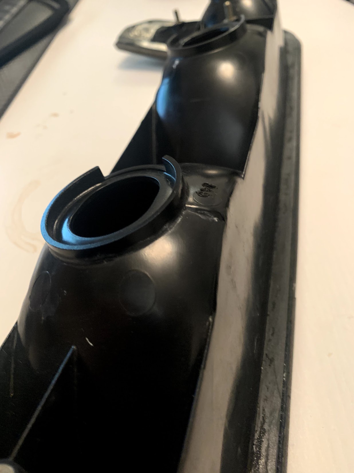

One of these is cracked too; it’s just the standard procedure of wet’n’dry to get them flat. You have to remember that flat surfaces reflect light, thus look shiney. These however, even after flatting had a lot of deep surface scratching; if I’d have carried on flatting the risk would be thinning the plastic too much.
The lacquer simply acts as a thick flat surface over the top, filling in the tiny imperfections and making the upper surface flat and level.
Ultimately, new lenses are the ideal long term solution

Yes I think I see now. I would like to keep my rear lenses as original as possible, the issue is my cracked one is warped outwards and so is very difficult to work around

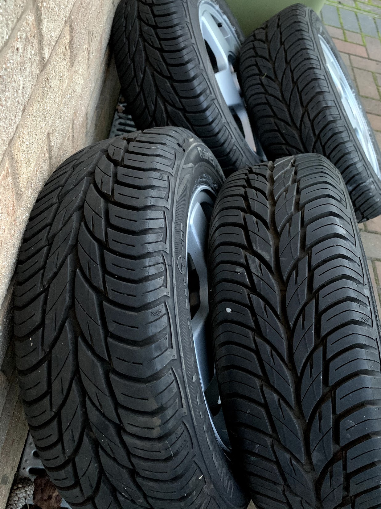

Hmm, did you do those wheels yourself? Thinking of doing mine, where can I get the right colour?
There's no such thing! Pick a silver you like and use it! These (and my other wheels) are done in VW Aluminum Silver Metallic (paint code: Ly7m)

What is the closest thing to the one that was used at the factory? I would do it with the centre cap on obviously and use a model enamel paint to do the Volvo logo
