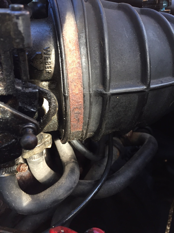

Having examined the engine today, and following jamescarruthers' advice, I had a look at the throttle bodies, they are the ovoid shape with apparently means I have a B18E engine, good news as that was the engine I was after!

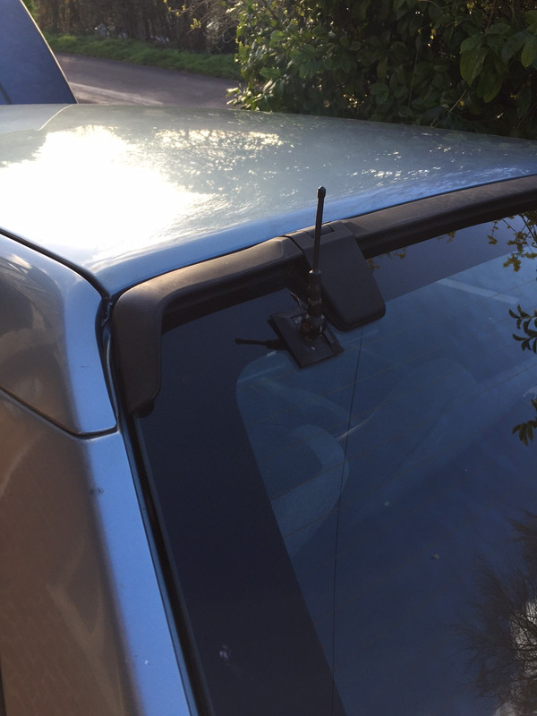

a few other enigmas with the car is a mysterious aerial in the top corner of the boot screen:

That looks like an old car-phone aerial to me...

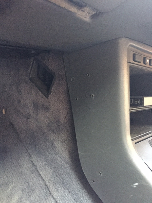

Are there any signs of one having been mounted in the car at some stage? I think the genuine Volvo ones were mounted on the left side of the dashboard but a likely place would also be the left hand side of the lower centre console. Any screw holes anywhere to suggest a bracket has been fitted?

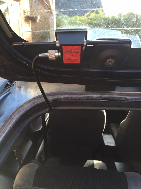

The strange bracket you have is possibly a cd changer or the equipment for the car phone. Would have been a big unit.

Good thinking Arthuy - I've had another look at the picture and I reckon it would certainly be a contender for a car-phone bracket...

while on the subject of extras, there is what looks like brackets for a car phone at one point
did all cars have this or just the ones with cruise control?

Deffo a phone kit; if you like I’ve a classic period Nokia car kit available (it came out of mine!)

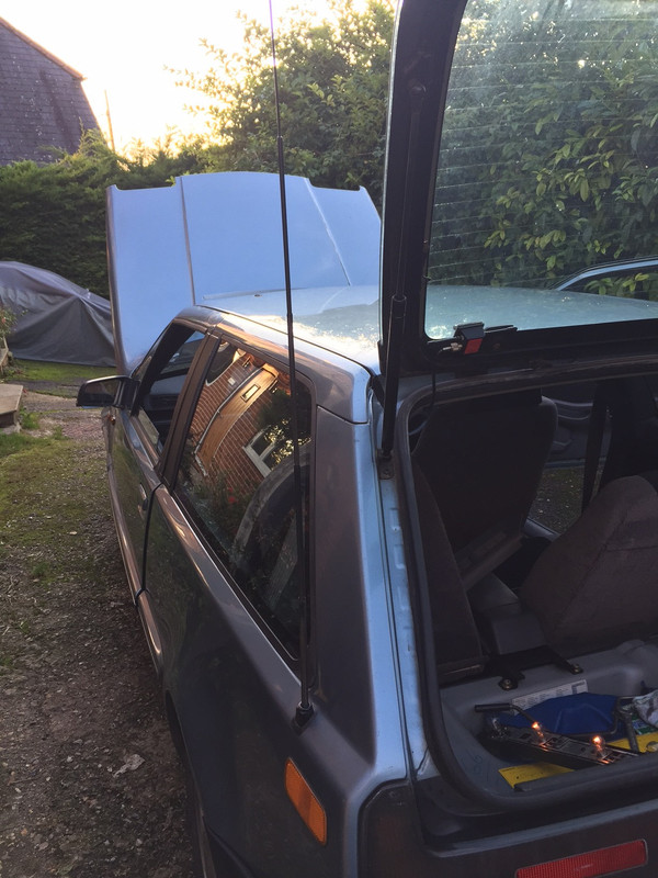

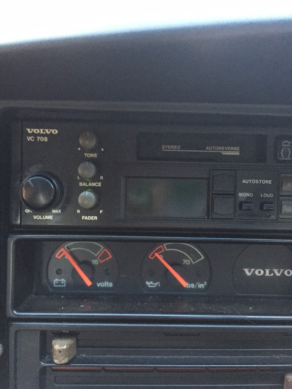

also fixed was the Aerial! now whirring happily up and down, however the Radio just shows a blank green screen, does anyone know what to do from here? also, when it asks for the code, how would I enter it?

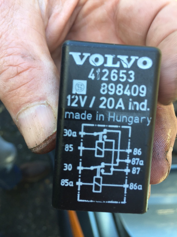

also, I need to find one of these for the pop-ups, I am tired of fixing them all the time, only for the passenger side to flip down again...

Regarding the code, you might be lucky and have the code on a credit card sized card in the handbook pack. If it is the original radio your Volvo dealer should be able to tell you the code based on the VIN number. Take some ID and the V5 and hope that the parts guys take pity on you. I got my key code this way.

From https://www.ivgsoft.com/radiocode.php?id=2231
Switch Radio On - Display Shows "-C-"
Press preset " 1 " and the display will show " - "
Press tuning up button "^" for correct digit
Press preset " 1 " to enter
If the correct code number is now shown press preset " 1 " to enter
