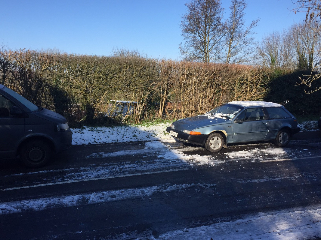

Post by MisterH » Sun Feb 03, 2019 2:03 pm
Dropped the car off at my local garage for an MOT yesterday following a snowy, icy introduction to the 2010's for the car. once the engine had warmed up, the car drove very smoothly and happily, and didn't have any issues on the road. at the garage, It was met with praise by our friend who runs the garage, he said that it was a straight car for what it is, to which I agreed. Under the car in the inspection pit, I smothered it in WD40 in all the drains and under the arches (It hasn't got any serious rust and the rear arches are near perfect, so I am not going to let that change now!) and had the first proper look underneath. It would appear that the front offside anti-roll bar could do with a change. I left the car at the garage for a cam-belt change and the completion of the MOT, and shall fill you all in on how that goes!
