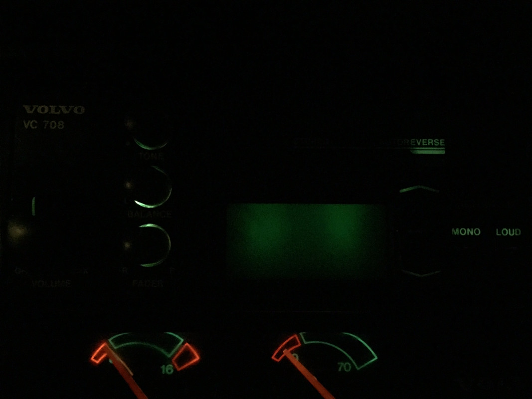

Here is a better pic of what I am seeing:
the radio seems to be picking up the static from the aerial when moving the sound knob, and when I press the tuning button the subtle background static seems to change

with that display I'd suggest 'fubbered', but happy to be proven wrong by those with more knowledge of electronics :-)
might be a similar issue to the way that the info centre works (or not) when the bulb has blown?? if you are lucky?

The middle bulb is blown on the display and you need a backlight to see an LCD display. Have you looked really really closely to see if it isn’t displaying -C- in the middle?
The static noise isn’t that important, you are just amplifying a noisy signal from the car and changing the volume knob is just wiping a dirty old variable resistor which will cause noise too.
OK, I will try that tomorrow, many thanks!

I’m grasping at straws really but good luck! The info centre does the same when the bulb blows and you can only see its display if you look really closely.

Looking at your last picture of the radio, I support the straw-clutching that has already taken place but must admit that my gut instinct says "fubarbed" :(. No great logic at all to this suggestion, but have you tried taking it out, unplugging it, then plugging it back in again? Might just be a dodgy/dirty connection within the multiplug connector(s)...

I think you are looking at a dead radio...
