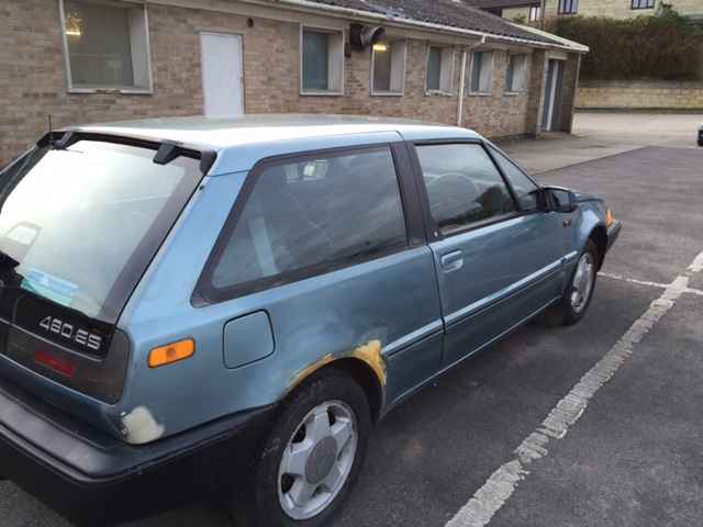

Yesterday, my long running quest to find a Volvo 480 ES came to fruition when I purchased a 1988 Volvo 480 ES. The car was last on the road in 2006, when it was last taxed. The car starts and runs briefly, but stops after a couple of seconds, a suspected MAP issue, the vendor is supplying the part that is needed as part of the deal. The engine sounds strong, and the dipstick is clean. There is no rust or rot as far as I can see, but it does need some new paint on the rear D/Side and front offside Wheel arch where it was previously painted the wrong colour, but it was already stripped in the required places. The interior is in good condition, but the radio/cassette does not tune in, but might try again at some point. the Info centre is working, however the pop-ups do not, but the lights themselves shine. Other things of note are that the front Number plate holder is not present, nor are the original plates or mirror covers, but apparently the previous owner may have them. its last MOT in 2005 it had 70,068 miles on the clock, which haven't incremented by much since.
I look forward to getting her back on the road, and I shall update this thread with developments in the story

Congrats on your purchase - I saw the car on eBay and was watching it, without seriously considering taking her on. As you say, it looks like the bodywork is in sound order, just needing a little paint. I'm hoping to get back into 480 ownership myself soon, depending upon an impending house move.
Good luck!!
