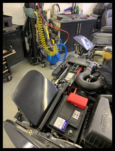

Quick update: the car ran out of electricity recently but conveniently died in a location which enabled me to coast to a stop outside our village pub.
Following a bit of investigative work:
(How many Barbours does it take to fix a 480?)
We decided the alternator was the issue, Jeff kindly supplied me with a replacement which I spent a morning changing. Turns out that our diagnosis was wrong and it was the mega fuse... Probably should have checked there first!
Anyway, Jeff has come up with an updated fuse/battery terminal setup from a Renault Megane. It isn't pretty but does the job:
(Yes the cables were tidied up!)

There was me thinking it was a neater, safer solution (mega-fuse included).
You can't please all of the people, all of the time, as they say.
Not mounting it on the p*ss helps.

That does look quite tidy! I will rectify my error immediately, consider me pleased as the car works now!Jay-Kay-Em wrote: ↑Wed Dec 15, 2021 4:57 pmThere was me thinking it was a neater, safer solution (mega-fuse included).
