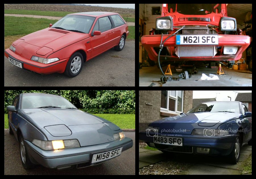

Mxxx SFC also reminds me of other 480s too... when you have been lurking these forums for many years, you get certain plates stuck in your mind...
