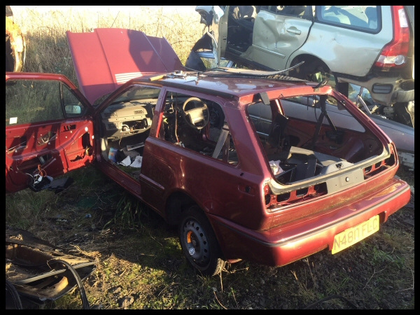

• Don’t worry Celebration N480FLC, you shall not die in vain. Your mouldy damp seats will live on. Yes, the dash plaque had gone…

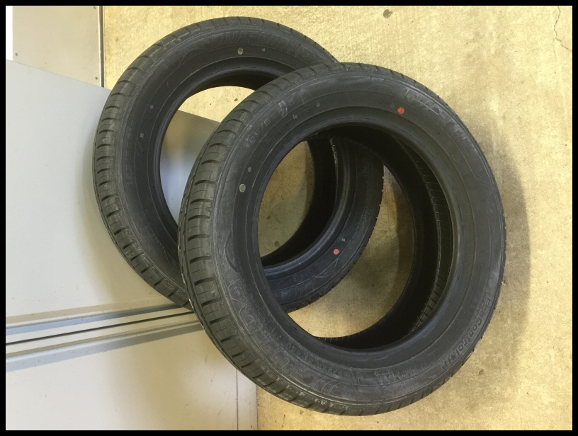

First of all I obtained two new Fulda EcoControl HP tyres so the vehicle was on a matching set of four. Needless to say it wasn’t already and had two nasty Chinese tyres on the back.

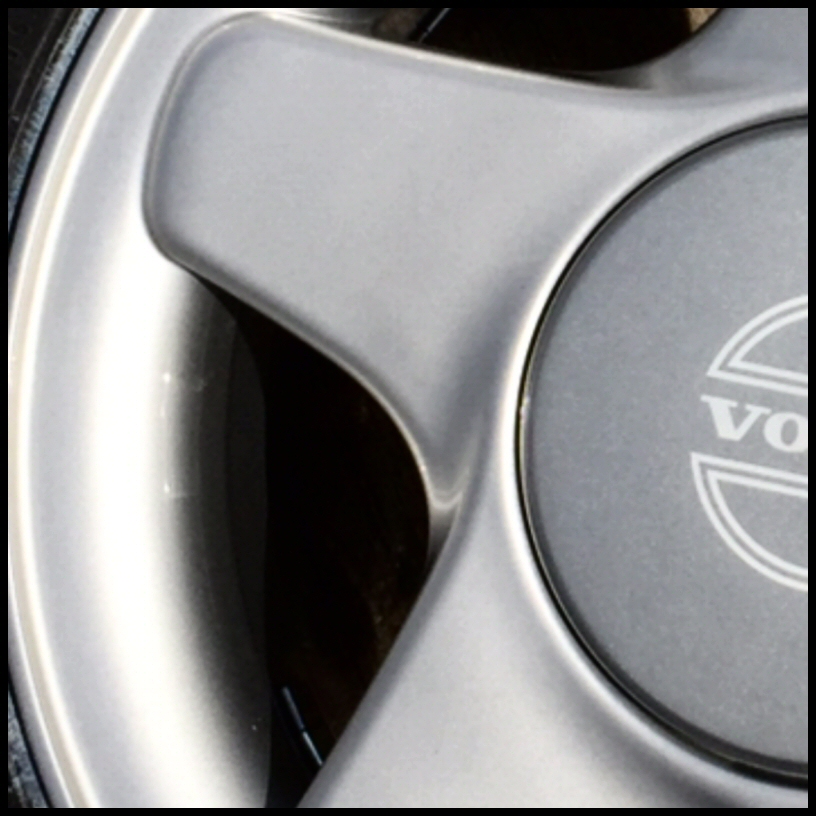

I used the biggest trim and wheel refinisher in Peterborough. It’s the top of Google. I shant name them, but they are on an industrial estate named after a car James Bond drives. I left all four wheels with them. I left them one centre cap. I said “you MUST match the silver to the centre cap. It’s a kind of ‘moody’ silver and isn’t generic.” They disagreed and said it’s easier to paint the centre caps too. I disagreed because it would lose the unavailable Volvo logo’s. That, and I want them the correct colour! “Just match the paint to the centre caps like any other bodywork job.”. They gave me a price and I left.
Three weeks went by, got a phone call and went to pick them up. They were in the corner of the shop. Where’s my centre cap then? They had lost it. They found it after some searching. I clipped in the centre cap and my heart sank. You be the judge…
Basically, they just painted them the closest off the shelf silver. They were shocking. They had mounted the tyres and everything. What were they thinking? I wouldn’t notice? “You need to re-do these”. They started to get funny. Anyway, they got out their laser-paint reader and scanned the centre cap. It came up with a moody silver for a Toyota. I left it with them. Another three weeks went by, and I went to collect them in absolute fear. Thankfully they were perfect. Unfortunately, because they had put twice as much work in, they then said their quote was minus vat and there was also a colour matching surcharge. Yeah right! I just wanted out of there so paid 1/3 more than I had expected / budgeted for and left. Its alarming when your alloy wheel refurb cost is a sizeable chunk of the purchase price of the car!
To be fair they look really good now, the correct silver they left the showroom in. When the cars finished you will see them in their full glory!

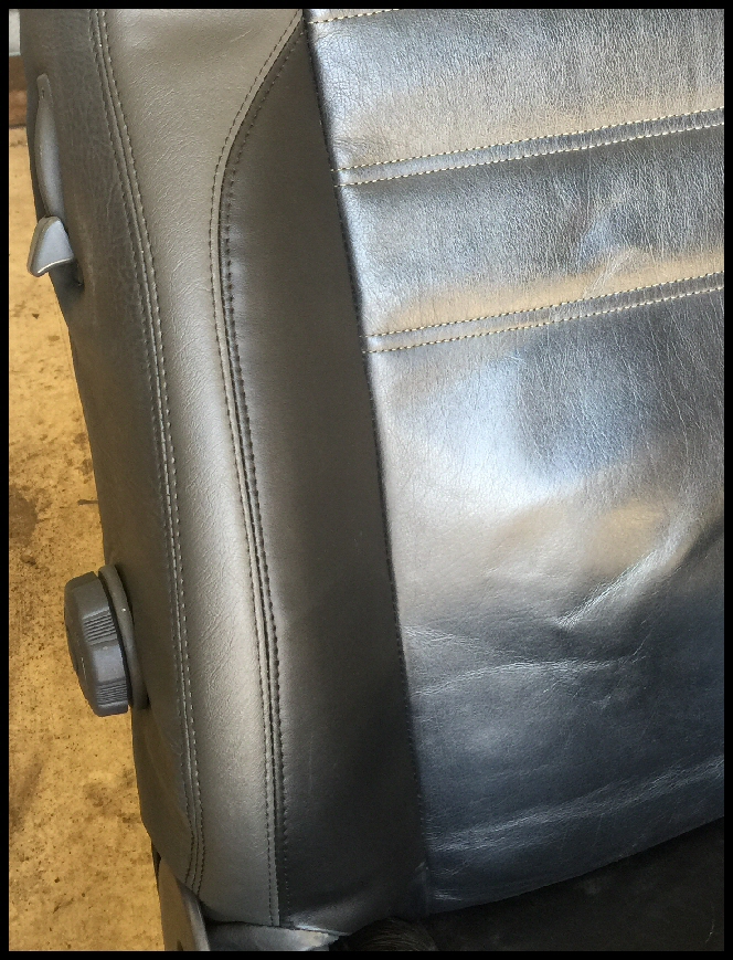

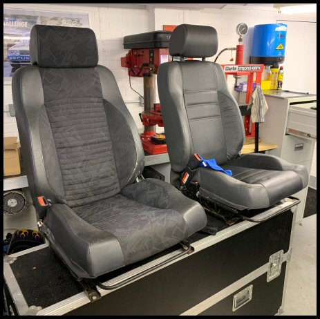

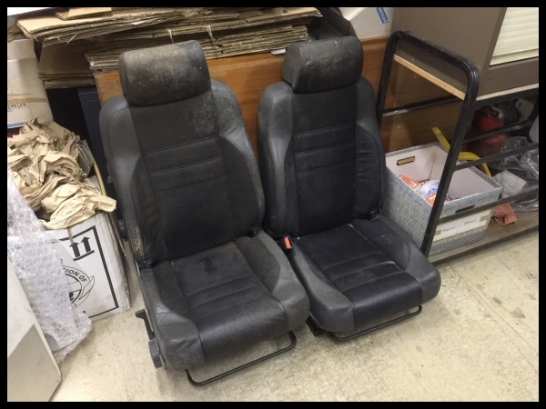

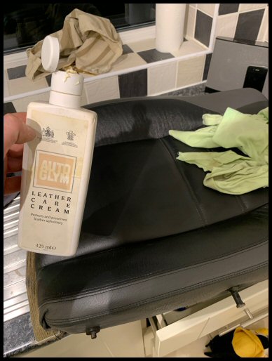

Some good news now, the weathered full-leather seats I pulled from that Celebration, with no doors or windows, have come up really well.
Despite the hassle with the wheels, the trimmer did an excellent job on the drivers bolster. He sourced near identical leather and even the stitching is spot on.
Its alarming when your seat refurb cost is a sizeable chunk of the purchase price of the car!

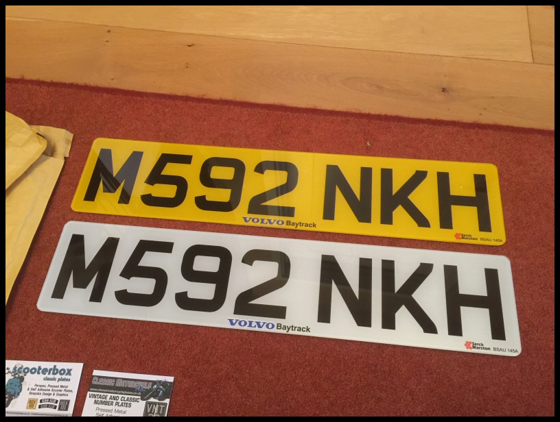

I am constantly sourcing parts in the background. One of these items are number plates.
I am a massive number-plate geek. Since 2001 letters have been much smaller in width. To me, they don’t look right on older cars.
I had some custom plates made, front and rear, with the older, wider, 1995 font and the original selling dealer name ‘Baytrack’ (now defunct) at the bottom.

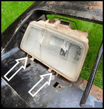

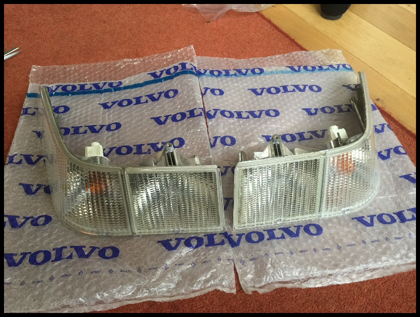

I have sourced an amazing pair of front indicators from fellow 480 forum member. Thank you Andreas, top bloke! “Andreas 202”.
Its alarming when just some indicators are a sizeable chunk of the purchase price of the car!

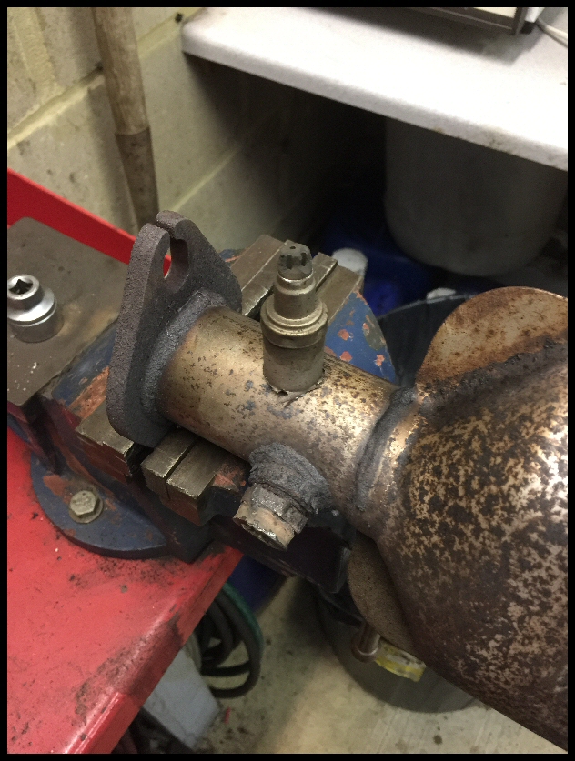

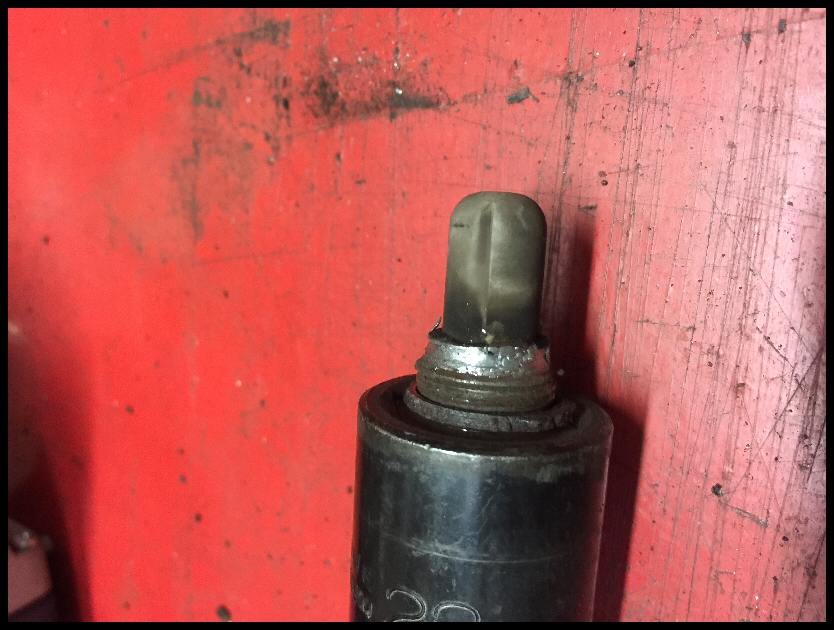

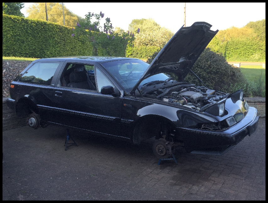

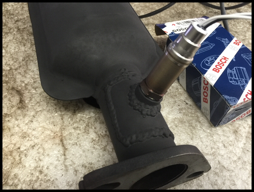

Decided to renew the MoT to see what the damage was. It failed, badly. Firstly, emissions.

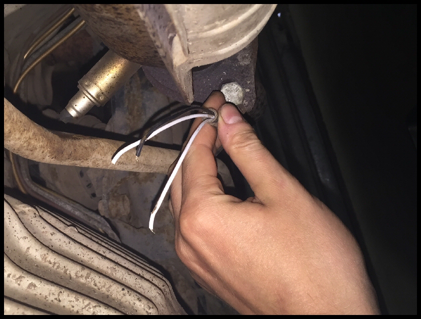

It has an aftermarket cat fitted already. Unfortunately, being aftermarket, it’s not quite correct. The O2 sensor is in the wrong place and its fouled by the gearshift rod. It can’t be the fault of the rod. This fouling had broken all three wires off the top of the sensor. You could see the polishing to the rod. No wonder it failed emissions!
I took the cat off and proceeded to rotate the O2 sensor 10 or so degrees round. Needless to say the O2 sensor was seized solid. I had to cut the top off to use a proper socket.
When it did turn, it just destroyed the threads of sensor and the boss. I had to get a new boss.
So, new boss, rotated round and a new BOSCH sensor, with the longest fly-lead I have ever seen! Bizarrely, the connector for the O2 sensor is by the battery!

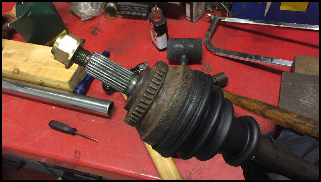

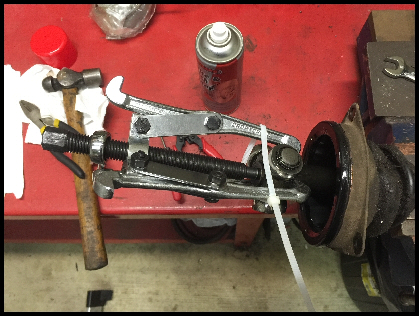

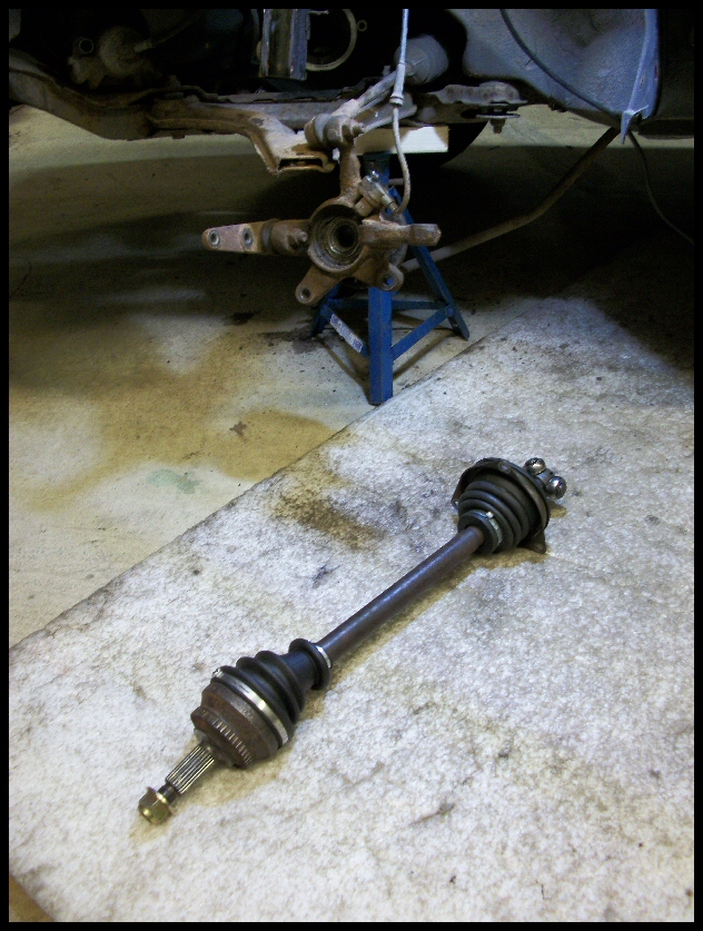

Further failure items included the nearside outer driveshaft gaiter. I removed the shaft and thought better do inner and outer.
Outer was a breeze, like any other car. I did clean up the teeth on the ABS ring as they all looked as one!
The inner nearside boot is more involved as it has an integral bearing and is pressed onto the shaft. You have to pull the tripod rollers off.

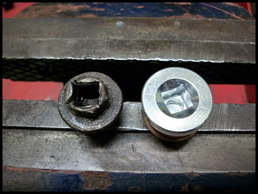

I had to butcher the gearbox drain plug out. People had used incorrect tools in the past and the square drive was found cracked. New fill and drain plugs sourced - all generic Renault items.

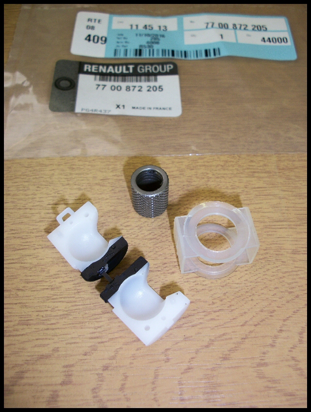

Whilst on the subject of gearboxes, I have sourced all the gearchange wearable items – from Renault. They are generic Clio/Megane parts.
I haven’t fitted it all yet but they are visually identical. The gearshift on mine is floppy as anything so any improvement is gratefully received.

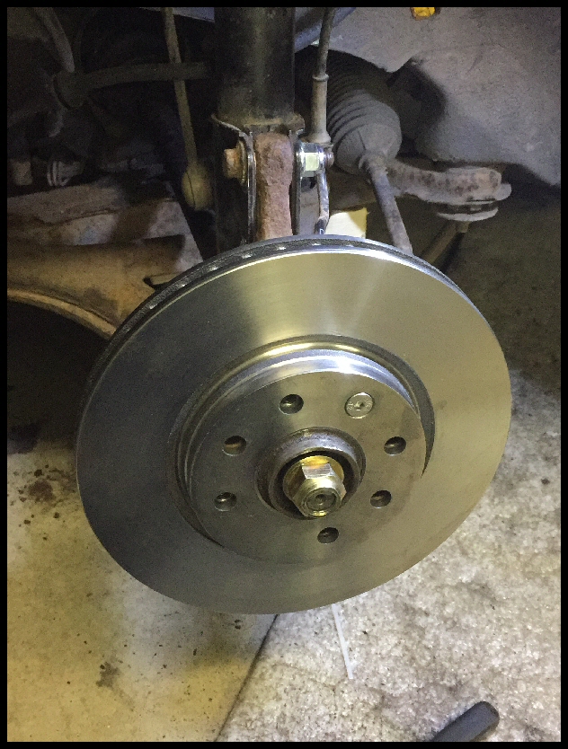

Finally, new Turbo vented discs and pads went back on.

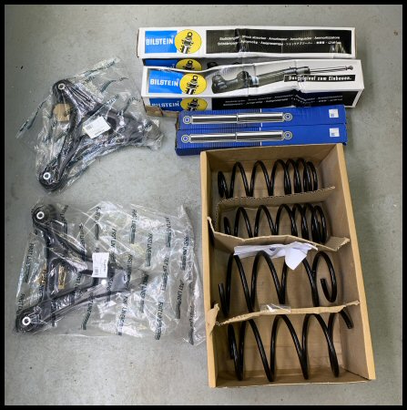

Another update to follow as and when. Still lots to do. Robou ECU, suspension overhaul, cambelt, speedo, dash illumination, interior re-fit, sunroof fix, bin the towbar, etc etc....

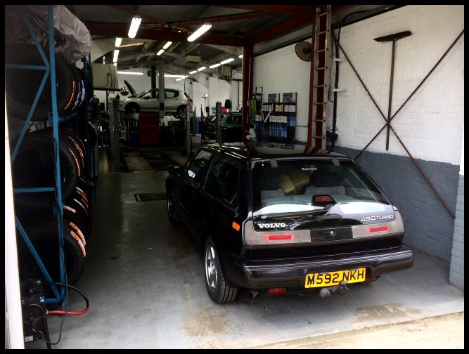

The 480 lived 'stashed' at work, untouched, for 10 months. Only recently I chucked a sponge over it to get it to my new home in Alconbury, near Huntingdon.

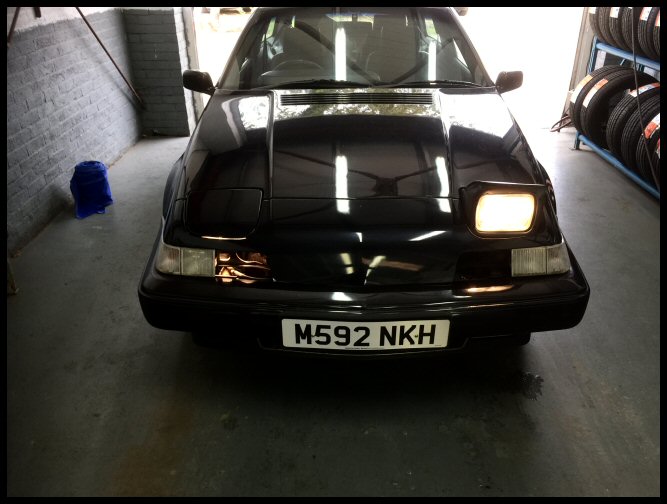

With no MoT or tax, I pre-booked an MoT to make me road legal for a day, just to get it home. Pass or fail was irrelevant really.

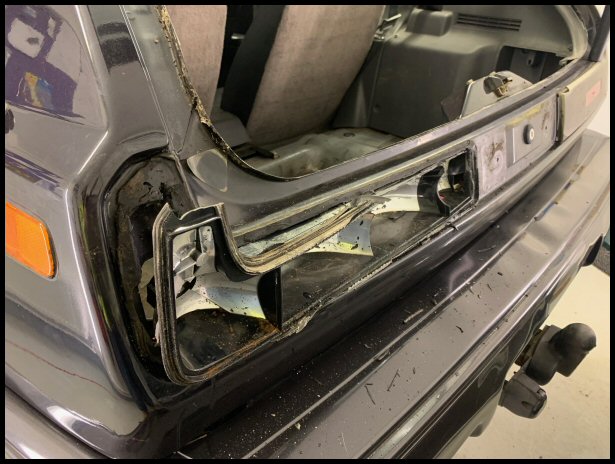

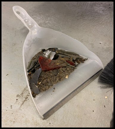

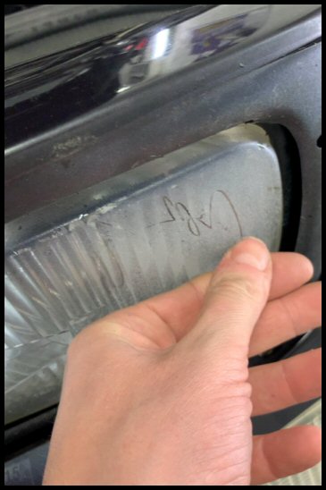

I must win an award for worst rear lights ever :lol:
Comedy pop-up headlight.... oh the embarrassment! Add that to the list ;-)

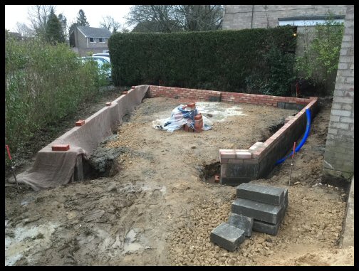

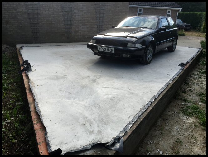

Work started on the 480 workshop; objective - get my tools back out of storage ASAP!
Anyway, base is poured, now looking for a brickie...
Its a funny shape, but has plenty of room at the business end. Its a wedge garage for a wedge 480 :rofl:

A long build, juggling many tradesmen. Tried to save money by 'splitting the trades', but ultimately paid the price in time taken.
Over-budget, way over-time and with snags. Like any building project then!
All kitted out January 2019. All my stuff herded back from mates garages and the storage container I was renting.
So, garage finally done! :hopping:

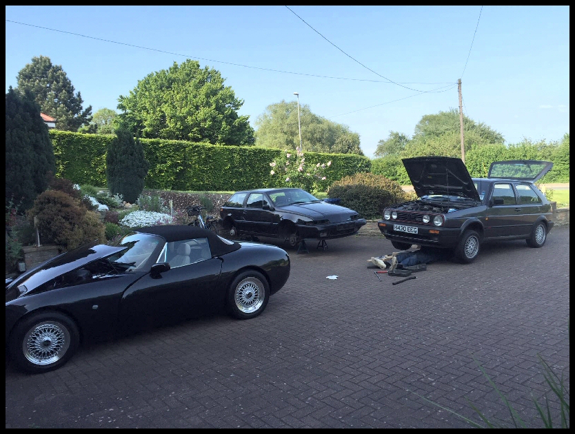

In no order of affection (obviously), the GTi went in first, as it's my summer daily-runner.
Image Image
• New PAS steering rack, cambelt, front discs & calipers + brake fluid, transmission driveshaft seals, inner CV boots and a refurbished headlining.
TVR next, as the 2019 show season was slowly disappearing.
Image Image
• Exhaust manifold gaskets (both V8 banks), engine mounts, all fluids (LSD and 'box), sump gasket, exhaust mountings, front discs and a brake fluid flush.

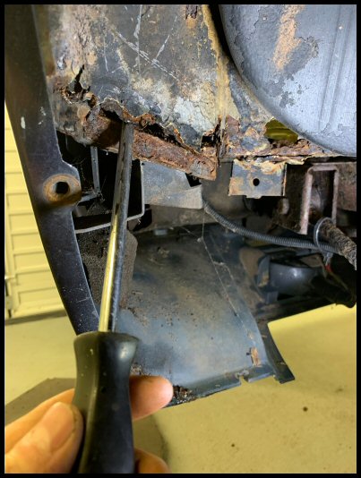

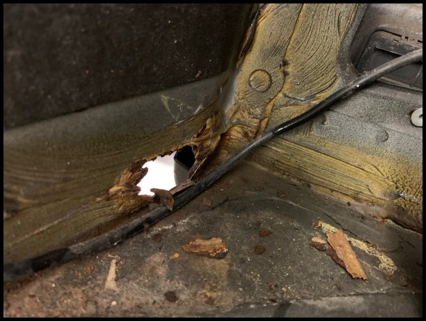

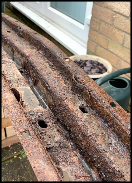

Predictable 480 job... scuttle trough full of water with blocked drain tubes... obviously!
3 years, six months and 15 days, finally in the garage!
Initial bodywork assessment not good... cant believe the deterioration in nearly four years. Cars do not like sitting about.
Need to create a list, what to clean, what to preserve and what to weld.

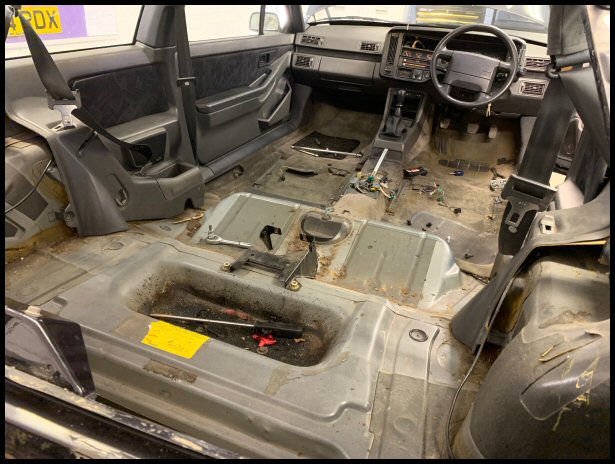

First job this weekend; remove interior for risk-free welding!

That garage is simply epic! Put a bed, kettle and microwave in there, and you'd never leave!

First job, remove those awful rear lights. First job, and its a nightmare already. They had been stuck in using the toughest adhesive I have ever known. It was like bonded windscreen sealant. Sure, they probably didn't leak, but blimey! Had to break them out.
Tip to anyone; if you are fitting good rear lights, think twice what adhesive you use (if any) because they will end up in the bin!
I do have the new seals from Joep when the time comes.
Seems kind of guilty that any rear lights should end up in the bin, but trust me, they were beyond saving.

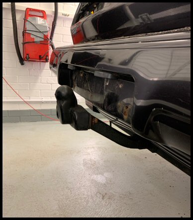

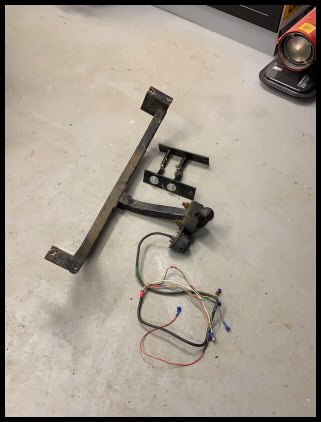

Second job; to de-towbar!
Currently on eBay if anyone wants it. Discount given for forum members!
Upon tow bar removal, this fell out. Literally no idea of its purpose, other than a sodden wet moisture trap rotting out my rear arches. Same other side. The screws holding it to the body are comical. What were DAF thinking? Answers on a postcard please.
Rear bumper off;
I've upset a few of these, I can tell you!

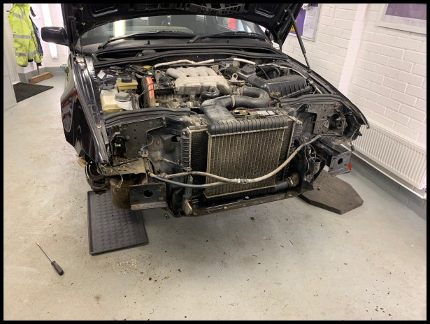

On to the front end, what cowboy painted the nose cone?... and what owner didn't notice the headlamps thick with overspray! Cleaning these will greatly imporve headlamp performance!

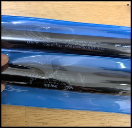

Talking of headlamps... 2x completely useless headlamp gas struts. I have found a thread where these have been located and I PM'd the OP but no reply as yet. Seems I just missed a group buy.
Really nice to see the front end bare. No crash repairs and all original. Very pleased.
Interior strip-out next, again to see what's what, and for safer welding.

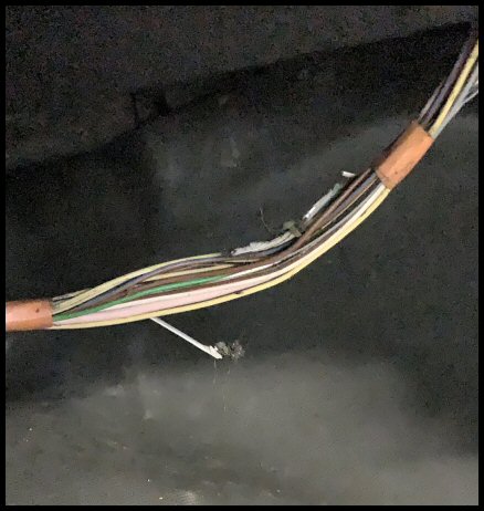

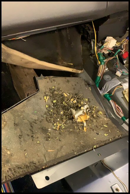

Below picture is the under-dash panel shielding the heater blower motor. Inhabited by a mouse at some point.
He has been nibbling on the dash wiring harness. The car drove into my garage, so don't know what Mr. Mouse has broken, and I don't know what i'll be fixing, but i'll be fixing something! :rofl:

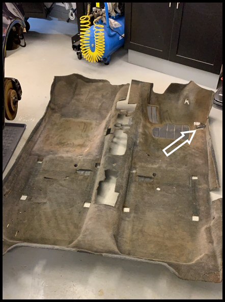

Carpets out; I had ideas about wet vac cleaning this, but it wants burning really. It also has a hole by the accelerator pedal.
(Adds a good carpet to the dream shopping list of unobtainium)
With the carpets out a good body inspection can take place;
Rear arches and rear boot floor pretty bad and the magic-screwdriver has been working hard finding daylight.
My first dustpan of 480 body...

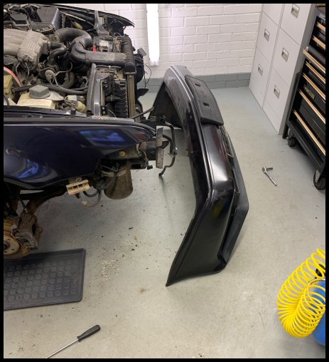

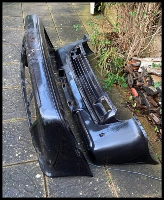

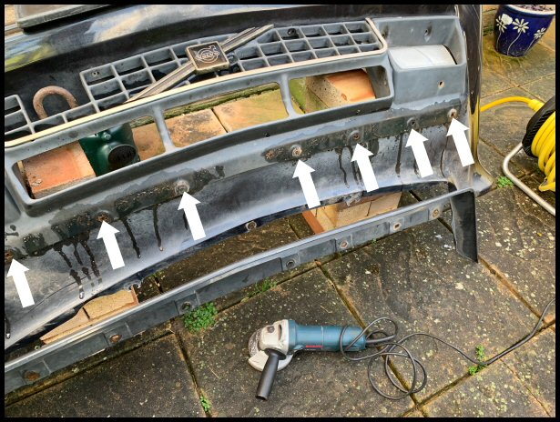

With knowledge from this forum about bumper irons, I started stripping the bumpers down. This is all old news really for forum members on here but I like to document it.
All front airdam screws corroded... angle grinder deployed.
Can I just say, these foglamp fixings are totally useless. They are 'phase 2' so they had a second chance to design them better, but still. Crosshead screws can't take the torque of any mild corrosion and they have partially blocked access. Then, the tabs of the fog lamps snap off anyway!
That's in addition to them using thinner glass.
Hey, guess what... my bumper irons are badly corroded! Well there's a thing! :lol:
I'll place them in the ever-increasing pile for the blasting & powder coaters.
Two bumper skins ready for the paintshop....

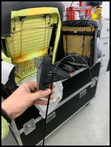

Totally out of sequence, but it's a bloomin' nuisance having to store 8 seats...
So I stripped the old half-leather down for all the spare parts, clips and cables I could. They are worth more to me as spares than to sell a well worn & torn half-leather set. I followed a worn half-leather set on eBay for ages and it never sold. Seems only full leather is desirable.
Carried over the best of the parts to the full leather and I have started to leather feed them every fortnight or so. The theory being, by the time they get bolted in, they should look very supple.
Second job of more 'non-welding' as I was fed-up hitting my head on the glass tailgate... new tailgate gas struts.
Lots of anonymous Chinese ones on ebay still, but I wanted a branded pair. Paid a bit more to get Quinton Hazell, a name I know, same part number and same packaging...
Except contained within are two totally different liveries :wall:
I am currently explaining to the supplier why my OCD can't handle this!

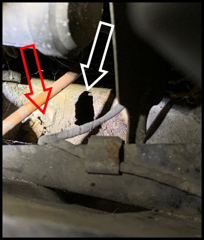

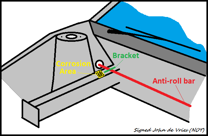

Anyway, winding down for Christmas and I was just assessing subframe removal when I noticed some suspicious deposits. Sadly the magic-screwdriver did more damage.
This is a picture looking down past the brake master cylinder from above, with the anti-roll bar mounting bolts arrowed (red). That is a hole just ahead of those bolts, on the chassis member. Location below...
Now I have been a lurker on these forums for 8-9 years; I know about bumper irons and rear arches sure. But I never recall this being a problem area. Is that because it's really difficult to spot? If so, check yours!
So I head into the new year contemplating:

Re: the chassis corrosion; wasn’t there a special notice about the chassis shock absorber thing? Snapping and causing corrosion?
I’ll see if I can find it.

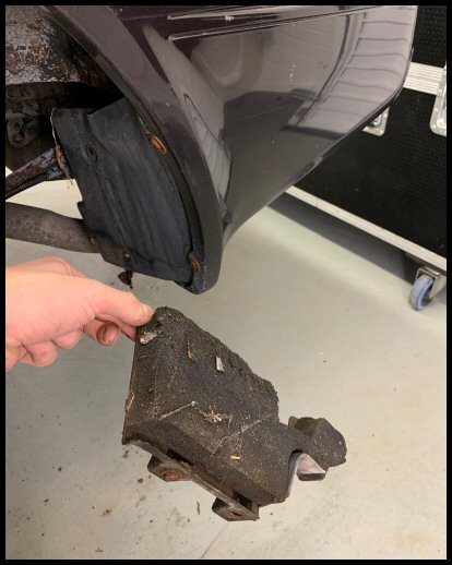

Re: the sponge.... Hateful, hateful thing. Every single 480 in the land needs ridding of this evilness
Re: headlamp struts? SGS Engineering do them (they don't list them, despite me telling them to!). Send them one as a sample, get two fabulous new ones back.
Re: leather feed. you need some Gliptone on them!
