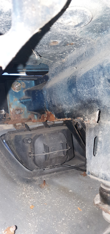

First thing though was the rust under the battery tray and frame rail and on the LHD driver side fame rail, I don’t know if this Is a common issue but mine had quite some of it.
There is also some similar surface rust on the inside bottom part, but I couldn’t get to it completely, and I didn’t really feel like doing that, as I don’t know if it’s worth it now. I used a drill and a wire brush to strip it down to the bare metal, then applied some Wurth rust converter which was lent to me by a body shop friend, and I was surprised at how good it was.
Then I left it on for 48 hours before painting over with a metal priming paint which he also recommended as it has some anti rust properties. And after 24hours I spraypainted it black so it didn’t stand out so much.

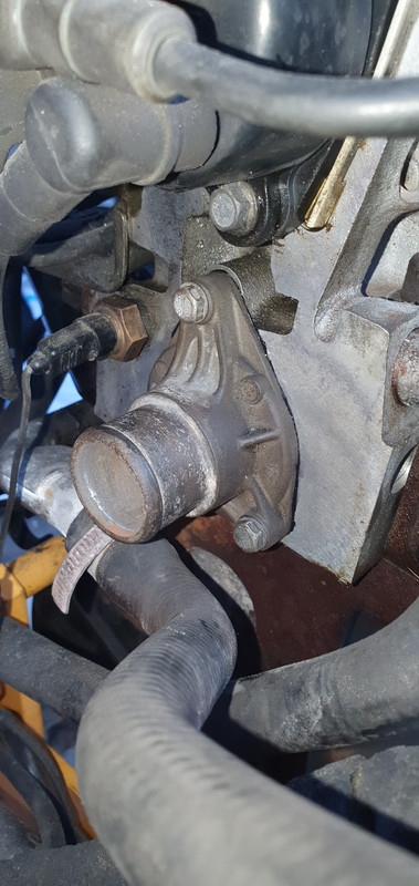

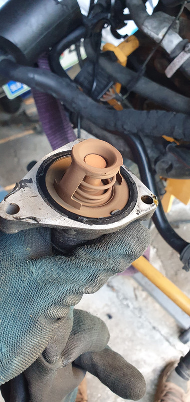

Next was the thermostat. The previous shop used a lot of RTV, and here it was no exception.
I just cleaned it off the head and the housing, added an rubber O ring and sealed it up to the head.

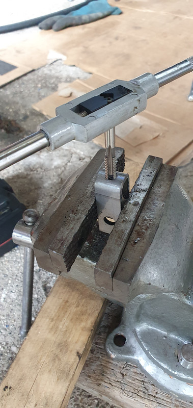

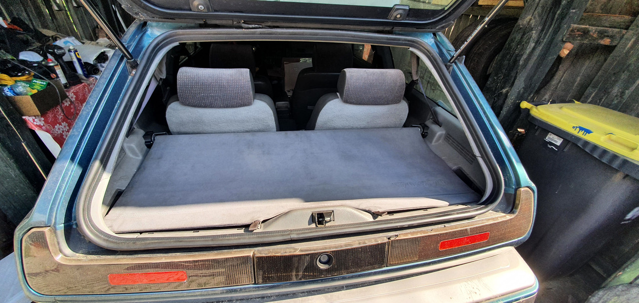

Uu the cargo roller cover was also a really great acquirement, but the mounts weren’t included, so I did some 3d modeling, send to a friend who is into 3d printing and wola, there they were. I know they are not the correct size and color, but for a fast prototype they work great, will do a mk2 version somewhere in the future and also if someone else will need them.

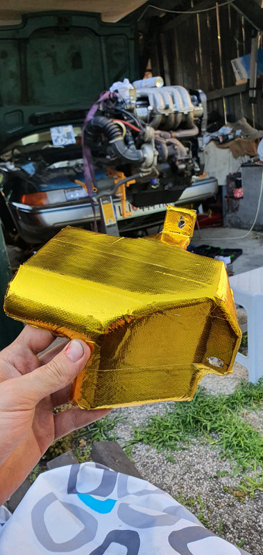

Heatshield also got new aluminum foil, but as one friend had some leftover gold foil left over from his project on putting it on the underside of the hood, he gave it to me, so I didn’t need to go and buy more of it. I also might attempt that, but I would prefer to do it with normal silver aluminum foil.
