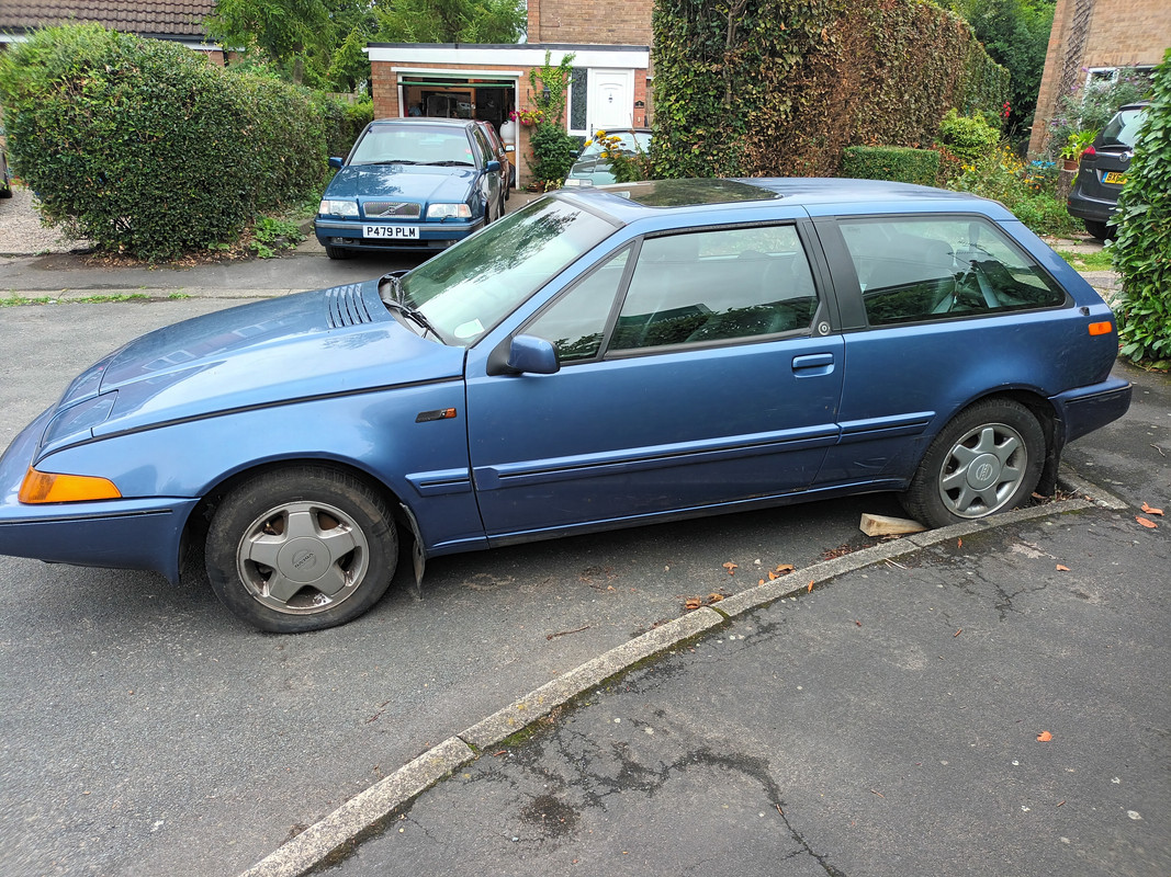

Very pleased to say we were successful in buying the Paris Blue 2ltr being auctioned on ebay.
As it is in Lincoln, it's not too far from David so he will be arranging to have it trailered to the Pamper Parlour.
It needs the clutch sorted plus all the usual stuff after sitting in a garage for many years. There doesn't seem to be much rust on it so we are hoping for a straightforward save on this one.

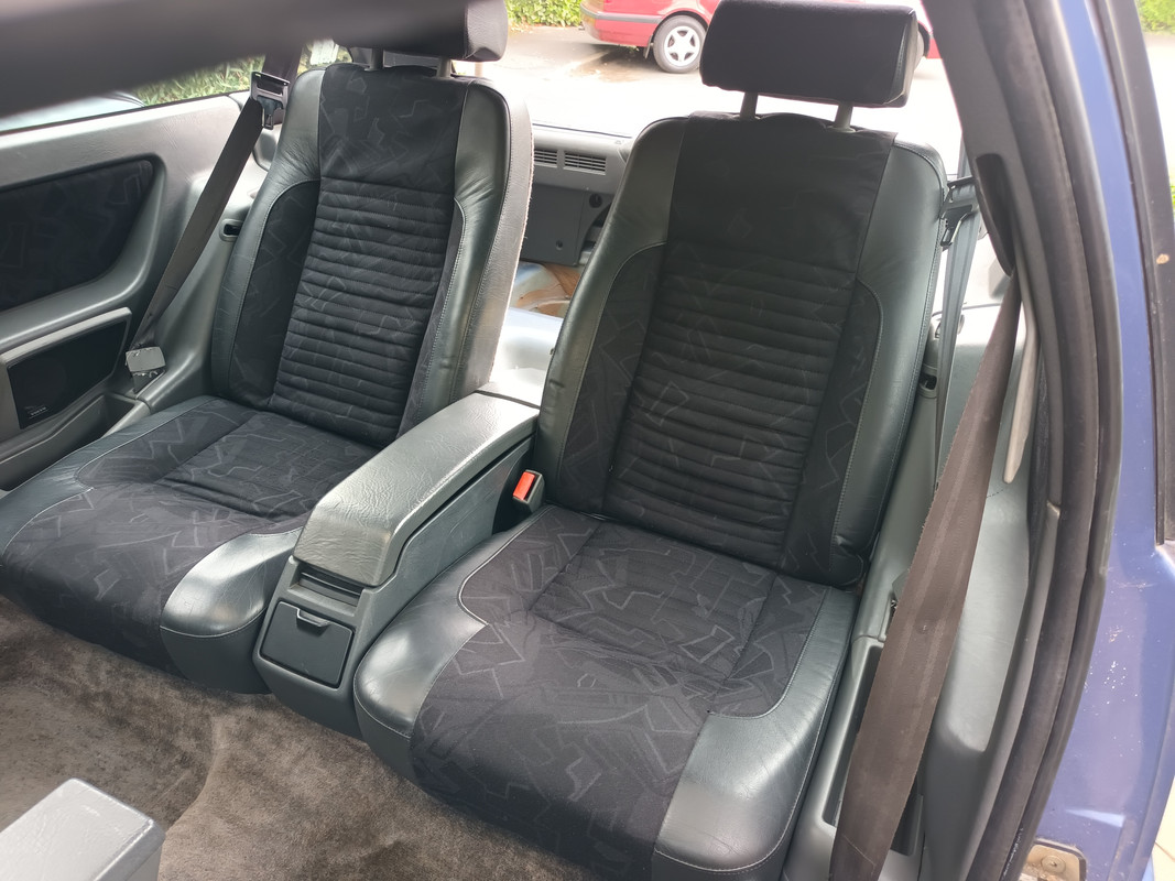

its got THE half leather interior people......
Late model ES, great colour, great interior, I'm genuinely excited by this one!
- Posts: 1556
Re: and then there were 9...... (rescue cars that is)
Same interior as R7, as well as Lily, my white turbo.

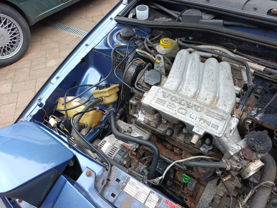

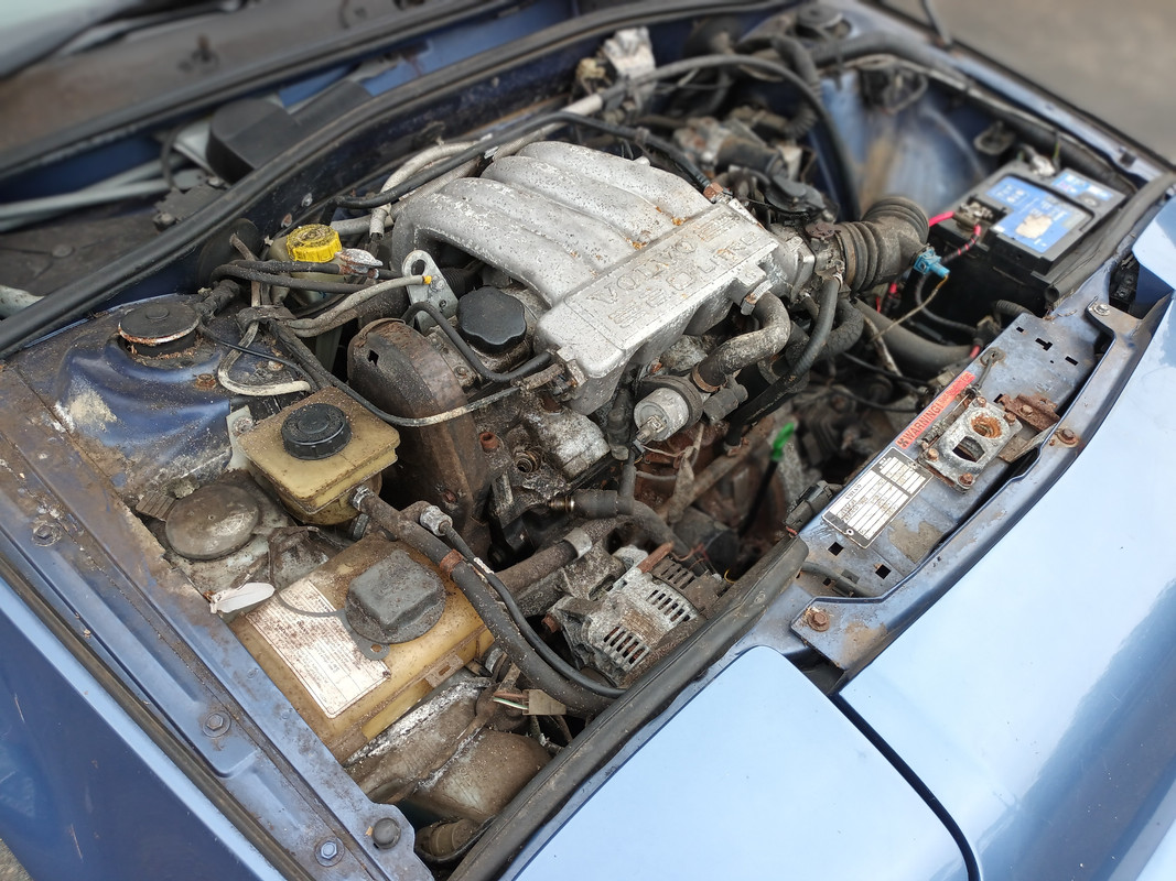

I decided to start under the bonnet - before putting too much effort into cleaning I'd like to know she actually runs, plus my understanding is that she was laid up when "the clutch went" - until I can run the engine and try moving Bluebell under her own steam, I don't know whether I need to just adjut the cable, or embark on the huge task that is changing the clutch on these cars.
It was filthy dirty under there....
Cant work with that, especially as the plugs are missing and I need to start with belts etc, so...
Time spent with grease remover, a brush, and copious amounts of water left the near side half looking like this:

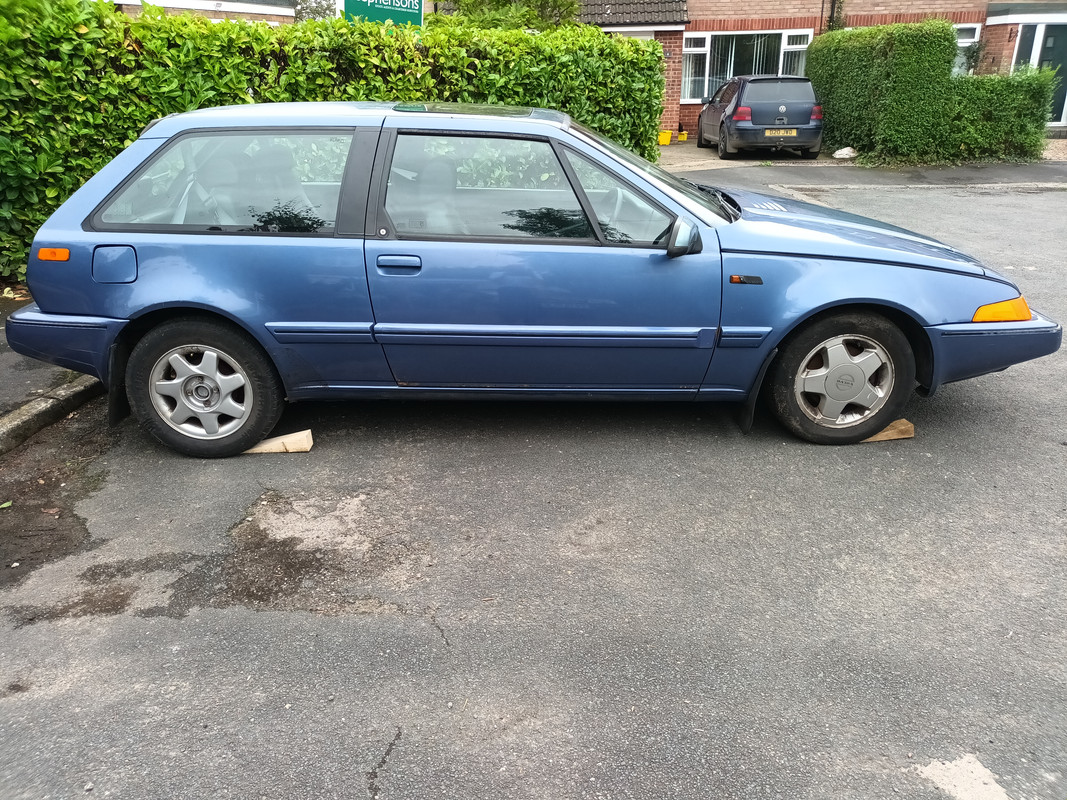

In regards to the mismatched wheels, I believe the Aviors are the originals. I think 1991 was the last year for the Pollux’s. Alternatively, you could upgrade to a set of 15” Taurus wheels (there’s a set on Marketplace I believe). Would look really nice with the Paris Blue paint!
William
I thought I'd lent my complete set of 480 brochures to Jeff, Will - are you sure you haven't nicked them? You're getting as bad as me!!WillC9303 wrote: ↑Sun Oct 23, 2022 12:04 pmIn regards to the mismatched wheels, I believe the Aviors are the originals. I think 1991 was the last year for the Pollux’s. Alternatively, you could upgrade to a set of 15” Taurus wheels (there’s a set on Marketplace I believe). Would look really nice with the Paris Blue paint!
Aviors are indeed the originals for a 1993 ES, the year they came in (on the 440 and 460 too).
Pollux were replaced by Atlas for 1991 onwards.
I always liked the Aviors, tbh - ideally that's what I'd like to see on her, for originality's sake, although ultimately she just needs a matching set of wheels!
Taurus were always fantastic looking wheels on the 480 (never worked on the 440/460 though in my view, where they were only ever options.....)

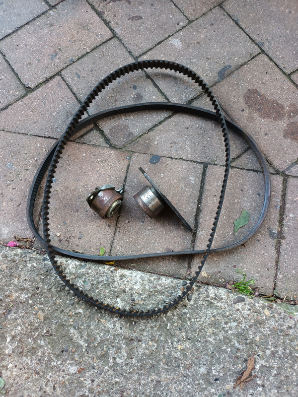

I then spent a happy day on a full service - new timing belt and pullies (not before time), Poly-V-belt (definitely not at all before time!), spark plugs, HT leads, distributor cap, rotor arm, oil filter (genuine Volvo of course) and oil.
Cleaned and replaced washer bottle, complete with a replacement front pump, and expansion tank. And here the mystery began, because the coolant expansion tank was not just empty, but bone dry.....

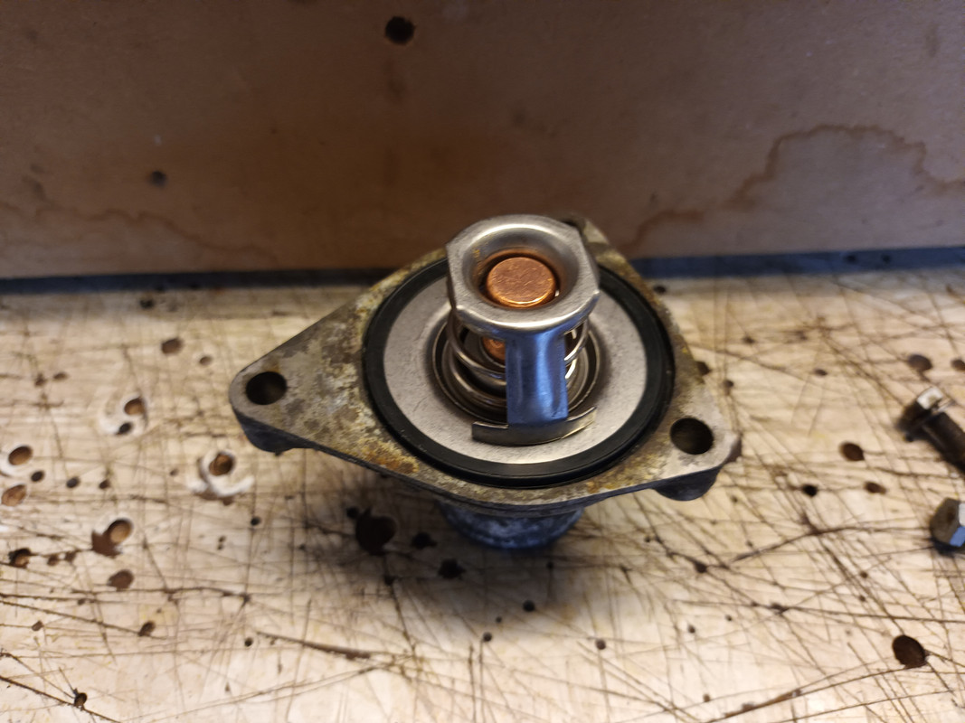

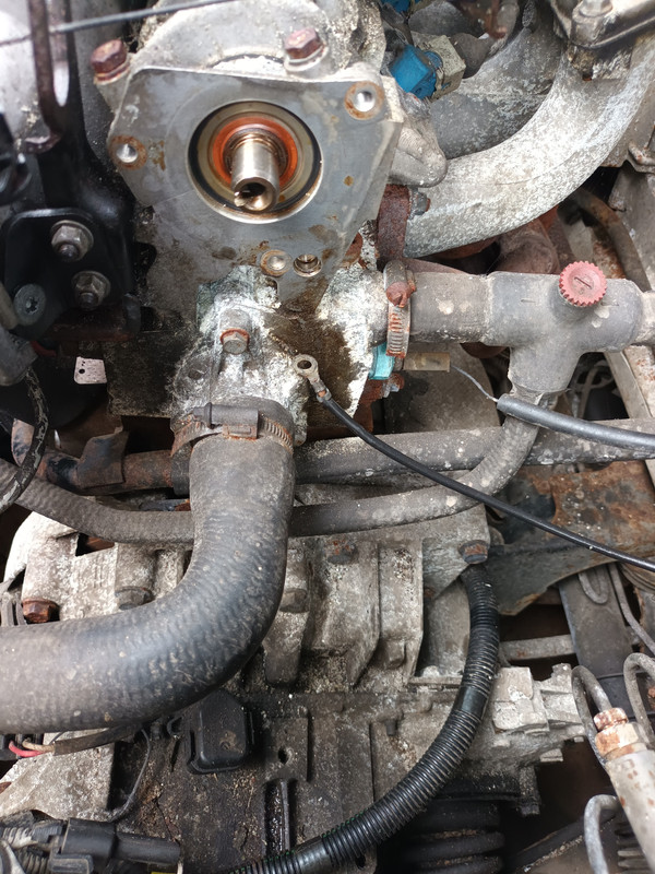

A clue lay in how things looked around the thermostat housing:
We've clearly had a leak there! The area around the water pump looked the same.

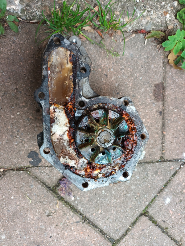

So I took the drain plug out of the radiator - and nothing came out, nothing at all.
Anyway, obtained nice new water pump and thermostat, and got on with the necessary dismantling. The system didn't look any prettier inside:

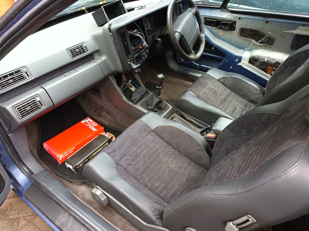

Again, it was all rather grubby but is cleaning up well. Because I'll need to work on the instrument cluster and reassemble the dash (someone appears to have started taking it apart then stopped part way) I haven't done anything with the driver's seat or footwell yet, but the rest is looking pretty good I think
See what I mean about the dash? Oh yes, driver's door card is off due to the need to repair the check-strap. Carpets all seem dry, leather clearly not been cleaned and treated for a while but it is responding well, and there is very little roof lining sag to report.
Still lots to do - brakes, broken spring at front, various suspension components etc. By the time she's finished this car will have undergone an intensive rescue job; I'm sure in due course she will make someone very proud
