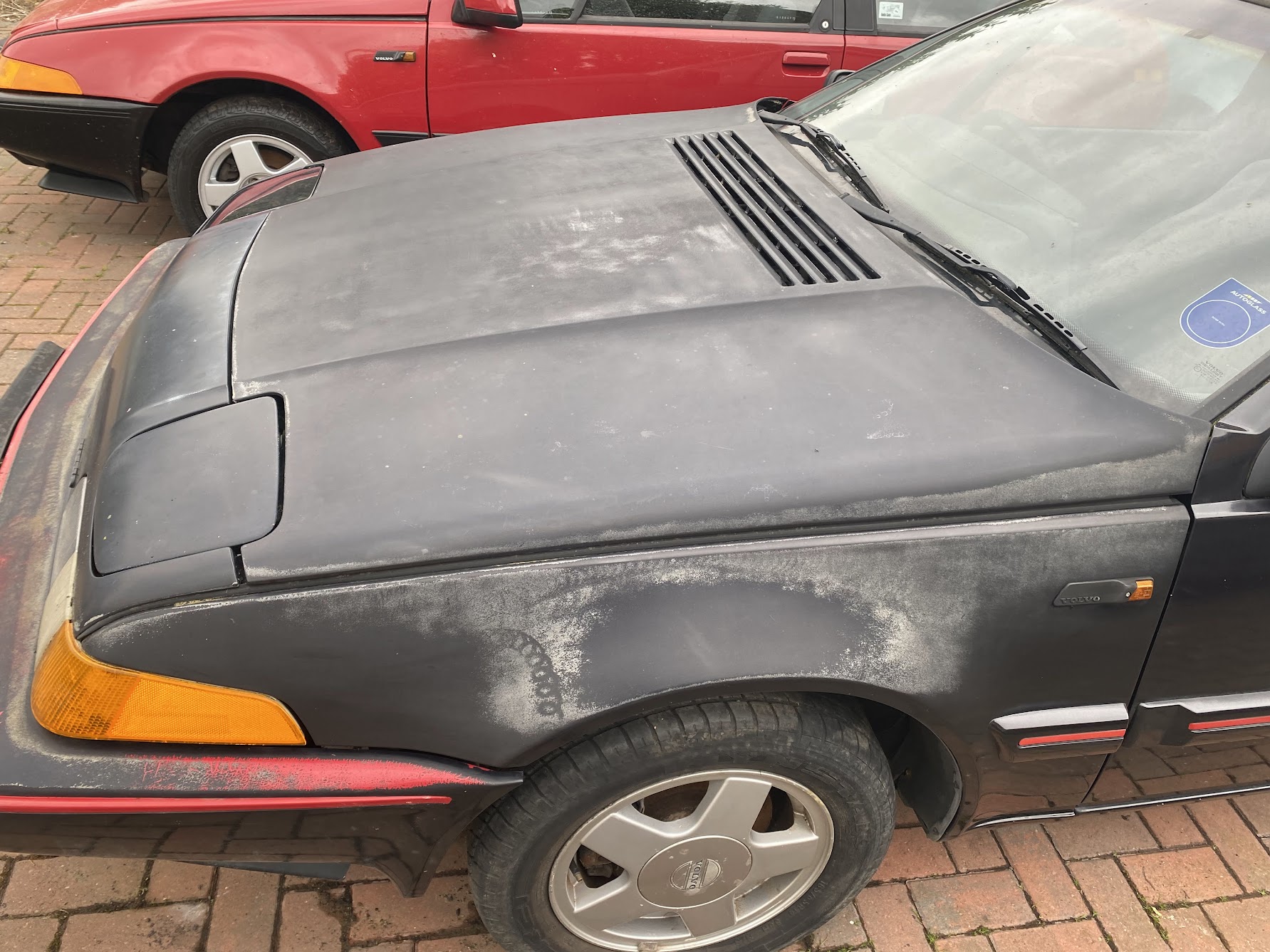

It's fair to say me and R8 didn't get off the best of starts.
Trying to unload a car with seized brakes is not fun. They had a mini digger to load it, there was just me to unload it!
This also did not help.....
The sidewall blew out a long time ago, so no chance of getting air in it. That's it jacked up to get it's space saver on in case you were wondering!
With it deposited (quite literally) on the driveway, I'm fairly certain everyone knows what step 1 is - Clean. A few images of why....

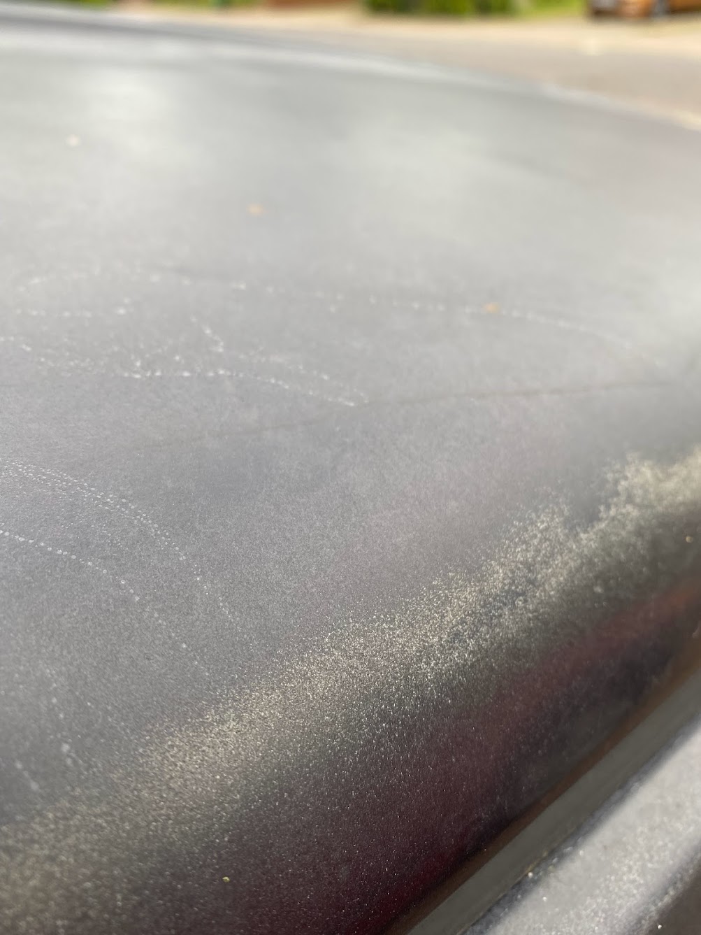

I spent a good couple of hours blasting away with the pressure washer, moving endless amounts of never ending grime. And if you thought the outside was bad, I had this waiting inside....
Overall, the car didn't look too bad when wet....
But sadly, when dry......
On the positive side, it means one less car to try and keep clean! Surprisingly, despite the vigorous pressure washing, the car remained dry inside! And whilst it definitely needs a respray, the lack of actual rot is quite refreshing...

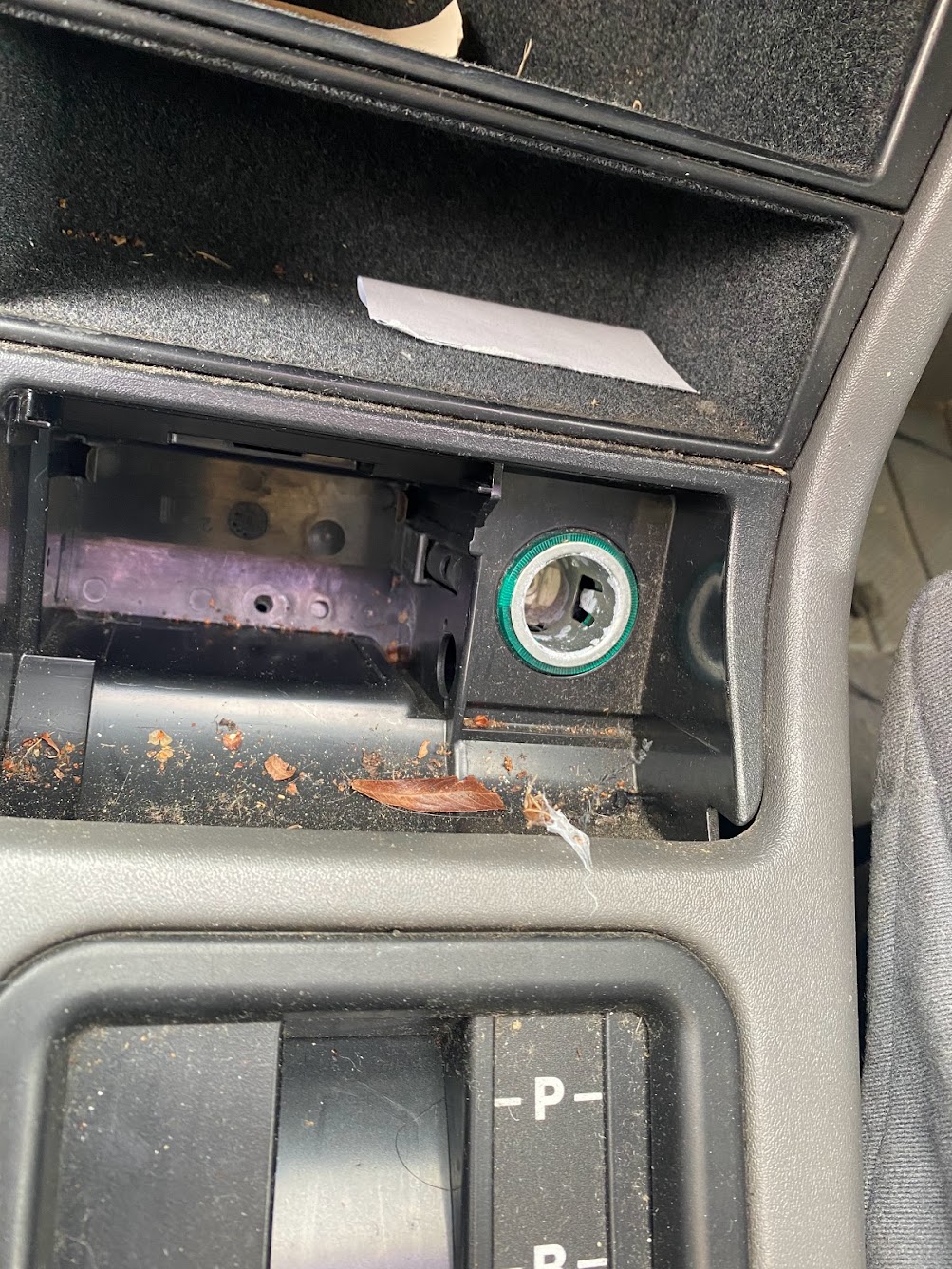

Right, inside next.
Obviously we need the seats out. So lets have a look at....
Oh joy.....
Thankfully, armed with the hot spanner, it was soon this
I know it sounds a bit obsessive to remove the interior to clean it, but it's quite honestly the only real way to tackle stuff like this:
and its that kind of grime that's going to make all the difference once the car is back on the road. So.... Carpet be gone!

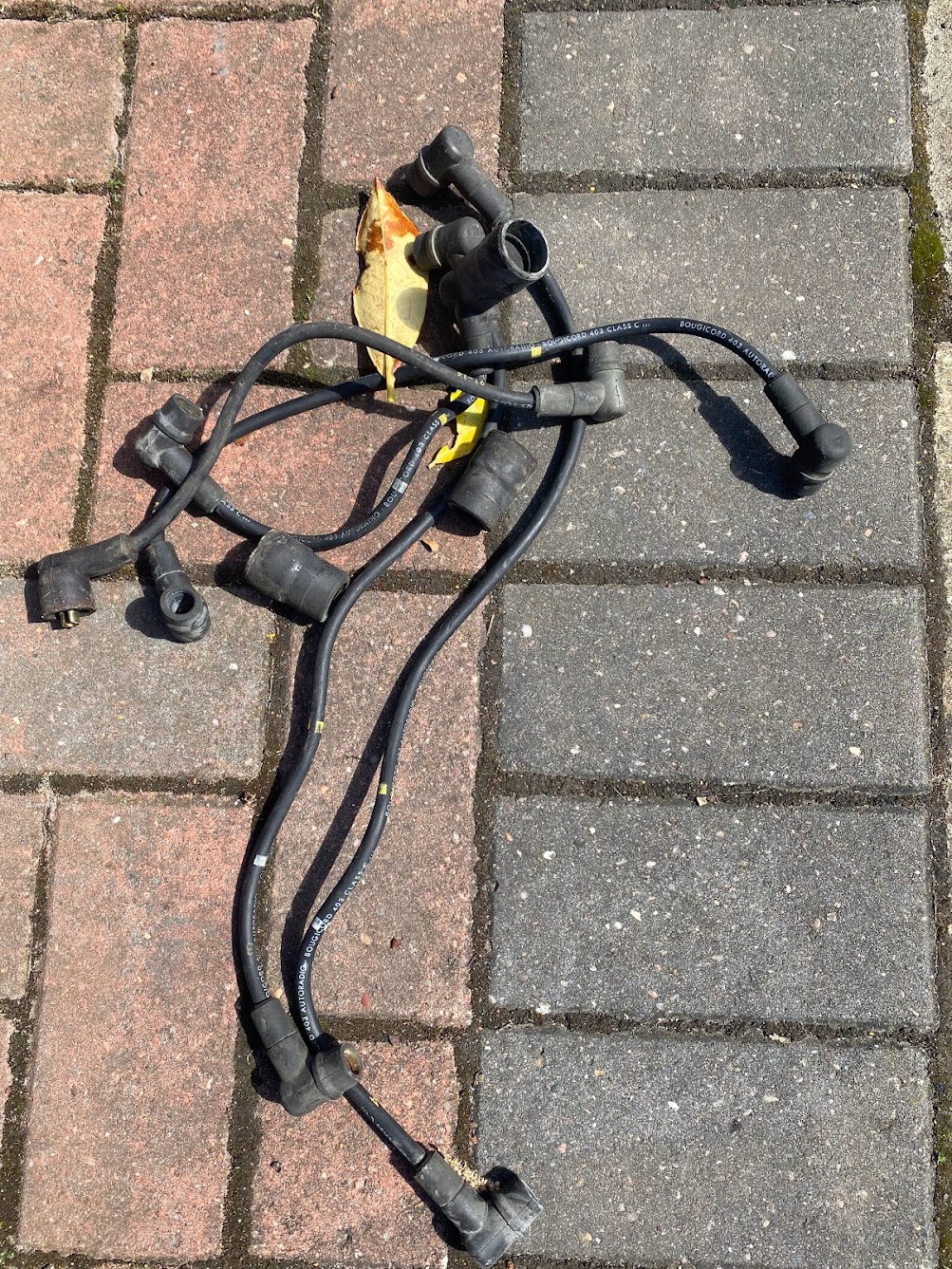

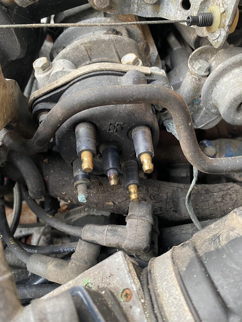

Then (and stay with me....) spark plugs out!
Absolutely past their best, but with them out, it meant I could fill the cylinders with some penetrating oil, as a precautionary measure. It also makes it so much easier to turn the engine over!

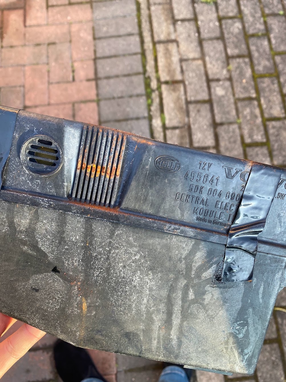

A quick scan of the wiring diagram showed that the previous electrical work was to connect the Dip beam feed, into the CEM.... only the CEM part was a CEM controlled earth. So at some point, you'll have a live feed going to earth, which is commonly known as "a bad thing".
It did, however, start to make more sense of the list of dead circuits.... The CEM getting a blast of unwanted voltage would indeed produce some smoke and make the CEM and EX-CEM. Horns run through the CEM and as you need one of those for an MOT, you bodge your way through. What's not clear yet, is what the original bodge that killed the CEM was trying to fix.
The red emergency rescue phone was used and it was confirmed we had CEM's available! So, onwards we go whilst we wait for stock.

New CEM fitted and suddenly the list of things that weren't working, suddenly were. Amazing! As mentioned previously, when I'd removed the plugs I'd loaded the bores up with some oil and had be rotating the engine daily to ensure everything was free and easy. So, with a working CEM, should we try and fire up? Key twisted to ignition, dash lights are on but we had a distinct lack of fuel pump noise... :angry: I checked the plug at the pump end - we were getting 12v to the pump and the earth was good. Bugger.
So more interior out.....

With fuel looking positive, lets look at the sparky end...
Not a good start (no pun intended!) so....
New cap, rotor and plug leads.
