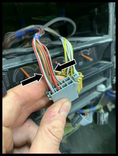

Strange radio wiring means it's on even with the keys removed (although this appears to be factory standard wiring for RHD, no idea what the logic is with that). Radio is aftermarket - maybe the factory fitted Volvo radio switched on and off with the illumination feed?

My car (a 1994) also had a permanent live in the "ignition switched" location.
No idea why. Both same wire colour too denoting perm live. Volvo obviously didn't get the memo about how ISO plugs should be the same because, err, it's ISO.

My radio wiring is exactly the same as yours in the photo JayKayEm. Studying the fuse chart in the owner's manual, and the wiring diagram in the Haynes manual, the LHD models are wired with both a switched and permanent 12V, whereas the RHD diagram is modifed. No idea why this is. The only 'switched' live for RHD is the illumination cable but that's much too thin to power the radio, it would melt the cable/ blow the fuse.
Fuse position 3 in the fusebox is unused, and is switched 12V too, so I'm going to simply cut and terminate the original thick grey with red stripe power cable at the radio end, terminate it safely (as I don't want a permanent 12V flapping about), fit a 10A fuse in position 3, run a 17Amp cable from that to the radio, and connect the new cable to the radio power input instead. It looks too fiddly to cut the original power cable at the fusebox end.
