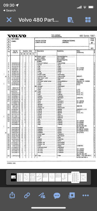

Post by Spainal » Mon Dec 25, 2023 4:19 am
Hi all!
Tell me where I can see the wiring of the vacuum hoses that come from the turbine and from the solenoid valve, which is located near the high-voltage coil. I’m looking for information and can’t find it, the vacuum from VEM and from EZ found everything clear, but I can’t find it on the turbine! Help!

Joe S
Posts: 30
Joined: Mon Oct 29, 2007 11:57 pm
Location: Reading
Re: Volvo 480 Turbo from Siberia
Post by Joe S » Thu Dec 28, 2023 4:02 pm
Hopefully this post contains the information that you need:
viewtopic.php?f=11&t=34487&p=208024&hil ... ur#p208024
Spainal
Posts: 110
Joined: Mon Mar 16, 2015 7:38 pm
Location: Russia, Siberia, Krasnoyarsk
Post by Spainal » Fri Dec 29, 2023 6:50 pm
Thank you friend! it helped me a lot!
