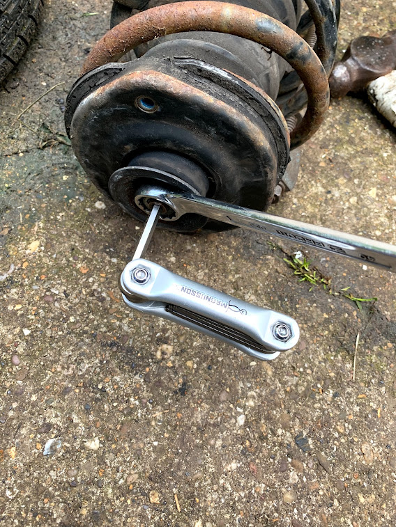

Posts: 984
Re: So, today was the day...
Post by jifflemon » Wed Jun 19, 2019 7:14 pm
You know that scene in the hurt locker?
That's how you feel when changing springs :lol:
Step 1: Squeeze 'em
Step 2: the evil bit - Allen Key and big spanner combo
Step 3: relax
