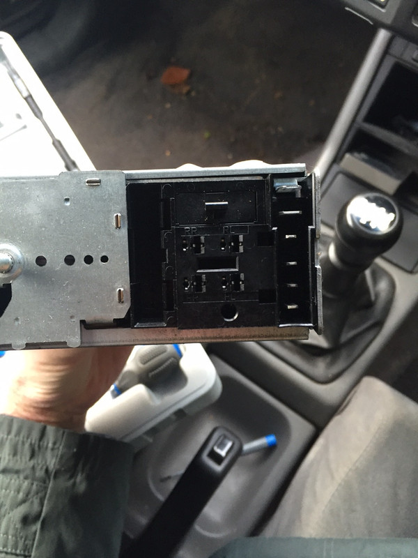

When you take the radio out, post a picture of the connectors and we can take it from there.

Here is the rear end to the Volvo VC708 Unit in my Car, as requested:jamescarruthers wrote: ↑Mon Dec 16, 2019 5:01 pmWhen you take the radio out, post a picture of the connectors and we can take it from there.
and the cavity from which it came:

Looks cool anyway! It will be compatible but you will need to either chop the wiring and fit new plugs or find an adapter to go between the two.
I suspect the easiest, but bulkiest way will be have an adapted from Volvo to ISO (modern plug) then an adapter to from ISO to vintage Alpine. I say this because it will be the easiest to acquire.
Can you ask the seller for a picture of the plug?
Re: What period aftermarket radio/casette to use?
It looks like the Alpine radio has standard ISO connectors fitted. No need to chop things up and splice wiring together, just a cheap adapter cable and you're sorted.

I would have got the tape deck but the CD head was cheap. The plan was to source and replace the CD for the tape deck so I could use a cassette adaptor.
The Sony units operate the antenna only when the radio is on and not the CD so nice feature.
These and the tape deck version were common fit to VW Golf GTI is 1995/98, also very popular with the car thieves who frequented our car park. I have a tape head with a 10 disc change in one of my other cars.
