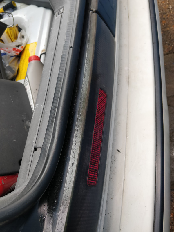

One of them does look quite tarnished, is the central bit at the back (where the key goes to open the boot) is that supposed to have a seal bcoz there's nothing there?
& Currently have the floor matt out in the bath to try dry off, so I'll pull the trim off again this weekend and try your idea!
1973 vw beetle
1993 480s
1993 480s
Re: Under boot floor matt soaking?
I think that there should be two samll rubber pads, about playing card size glued to the reflector and then thes are pulled tight with the two samll screws, NB be careful not to over do as the 'captive screws' can get ripped out of the plastic backingThemasteryeti wrote: ↑Tue Mar 14, 2023 7:00 pm
There's nothing to actually "seal" on the centre section. the Foam pads are just stop vibration damage
