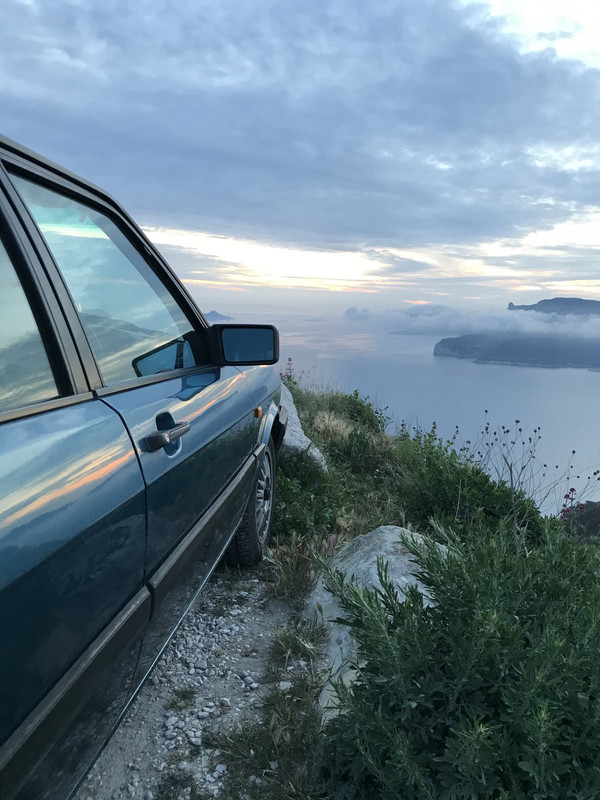

Sort of on topic, I would be careful with what tapes you use as some can be very underwhelming. For a badge you would want something very thin, some of these tapes are almost a mastic level of thickness, so if you can find a place to handle them before buying, that would be very beneficial.
While it isn't a badge as such, I have had a right old saga keeping the side trims on my 80 Sport in place. I first used Halfrauds own, which was great until it rained the next day. Then I used 3M double sided, which is much better, but the warping in the plastic is stronger than the grip from the tape, so the drivers door strip kinks out rather embarrassingly, it is much worse now that in the picture, so I am still on the lookout for something "heavy duty"
