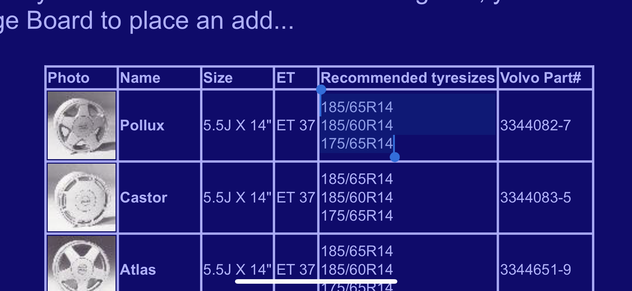

Post by jamescarruthers » Wed May 11, 2022 9:16 pm
No idea where the information comes from on our site but hope this puts your mind at rest that it’s not the end of the world having the slightly taller tyres:
http://www.volvo-480-europe.org/volvo480/wheels.php
It was probably done by a previous owner because of cost as the 65% tyre may be a bit more common and therefore cheaper than the 60% one… I’ve bought one with them installed in the past and also fitted the 175R65/14 size winter tyres as they were considerably cheaper and I figured thinner was better for that application— but we digress now!
I understand where you are coming from re:pedant as I would be the same.
What is the date code on your sidewalls… if they are ancient then that’s more of a good reason to get rid of them. Less than 5 years is okay in my book.

I only got them in 2019 when I first recomm'd the car, they have been stationary for a long time though, but they are still quite fresh. They have done 10,000 miles

Sounds good to keep as long as they haven’t accidentally done a mis-match but do understand the weird urge to have them swapped! I’ve got cheap and nasty tyres on the Citroen and can’t wait to get them used up
