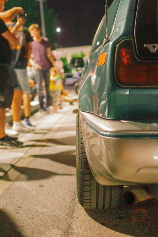

I have 15x8 et 18 or 16 steel rims 195/50/15 ps3 tires and KAW lowering springs. In the front there is no rubbing at all full lock is as normal, there is about 15mm gap for the "fitment" to be flush while in the back I had to roll the fenders because when going over speedbumps or if I had someone in the back the tires started to cut themselves.
This is how "low" :cryhard: :cryhard: it sits on 45/30
Sorry just seen your reply!
It looks killer with 8s 😍
How did you go about rolling aches? Always hear about people doing this

Well the rears I only rolled them to a V shape, I didn't fold them completely, so i will need to do it better. Using a heat gun and patience no paint chipped or cracked :wink:
