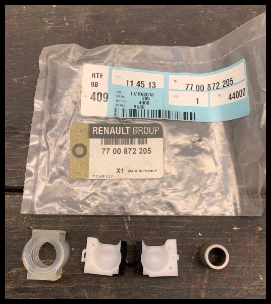

The bushing comes there (marked)? Or on the stick side? On the stick the gearbox feels awesome, not loose nor play, it's firm. On the picture, looks like something broken, but I can't find any original picture from the linkage, only mine what is broken.

I got the gear selector thingy.
https://www.ebay.de/itm/235137314973
Thanks!
I hope I don't need to replace the rubber on the nut, I can't find the part.

Post by Alan 480 » Sun Apr 14, 2024 2:37 pm
threepointsix wrote:
Fri Apr 12, 2024 9:13 am
Thanks!
I 'think' that the rubber thingy is an 'option' :wink: mine is well past it best by date and was only a dust cover (or collector)
