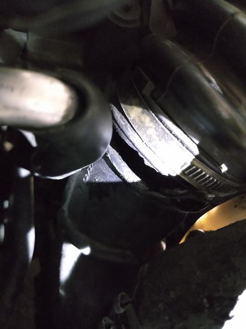

Found it ! Has to be that....
BIG tear at the joint of the hose coming from the MAF with the lower one going to the turbo.
Also checked MAF filaments: all in place. Also checked MAF resistance: was at 190. turned it up to 320 and it's ready to go in once I find a set of new hoses.
Has anyone tried this?

Yes that tear must be the problem, good that you found it before changing and testing more stuff.
Had similar problem with that hose on my old turbo and ended up runnning for years with duct tape :) since I could find a replacement hose.
