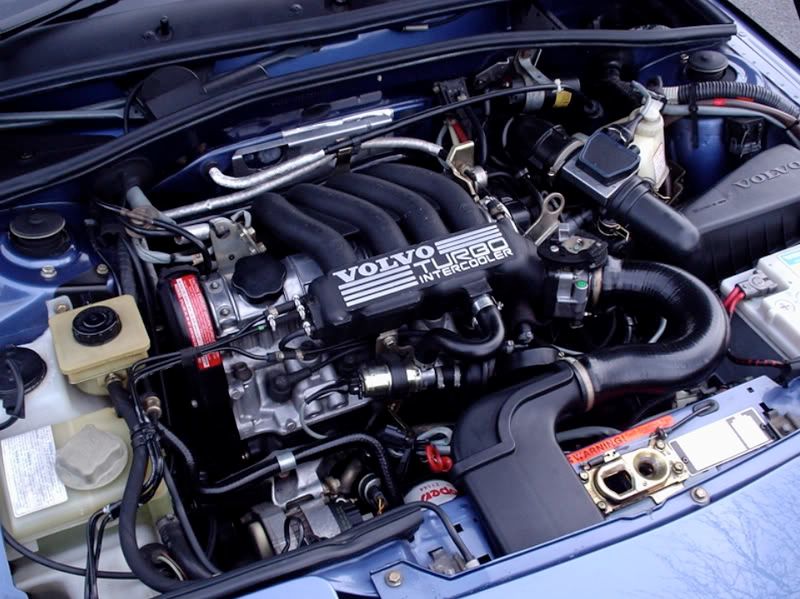

Taken all the pipes off again today to check for splits... None. We also checked the shaft on the turbo, and that is fine: it's spinning freely and slows to a stop freely.
I made an error in my original posting: after taking it out again today, the noise we used to get on gear change from the wastegate (like a very faint but noticeable flutter, like an aftermarket wastegate would) is no longer apparent. It's always done it, but now doesn't.
It does move freely with the bonnet up so it's not rusted solid or stuck-you can pull the rod in and out as you should be able to. Thing is, we don't know if it's that thats broken (internally) as we can't see inside it, or if it's anything to do with the little unit to the left of the coil which it's attached to.
So, opinions this time? Oh, and what is that little unit to the left of the coil....

The "unit" is the boost control solenoid. It bleeds off some air to effectively increase the pressure before the wastegate opens.
