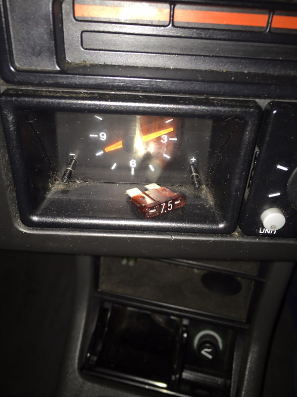

also, there are 2 mystery fuses in the storage compartments in the centre console
does anyone know what this is needed for?
Many thanks

Re: the mystery fuses. Check your fuse box (drivers side dashboard). It should be labeled with the correct fuses (they vary between models and years) however they could simply be that previous owner needed 1 fuse and they came in a pack of 3!
